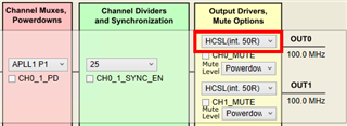

LMK05318B: out0 Abnormal output
Part Number: LMK05318B
Other Parts Discussed in Thread: LMK05318
Hi Expert,
My customer found there is no output clk signal on OUT0. They use Lmk05318 to generate CLK to PCIE3.0
Below is the schematic:
They use GUI to set up the registers, below is its export:

Are there any errors with its registers? or schematic?

  • Hi Moon,
    1. I tested the register file and was able to get an output on OUT0.
    2. Are R638 and R636 populated on the board? In the schematic, the two resistors are populated but the register setting used for OUT0 format is "HCSL (int. 50R)", which means that OUT0 is incorrectly double terminated (50 ohm to GND internally and 50 ohm to GND externally). Please confirm if this is the case.
    3. Does OUT0 not show up at all or does OUT0 sometimes show up?
    4. Please probe all other outputs to confirm only OUT0 is not showing up.
    5. Please probe VDDO_0_1 and all VDD/O pins to make sure the supply voltage meets the datasheet spec.
    6. Can you please provide a scope shot of the PDN, VDDO_0_1, and VDD_PLL1 supplies at start-up? I want to confirm the ramp-up is per datasheet requirements.
    Jennifer
