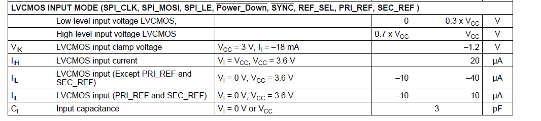

What is the recommended way to interface in LVCMOS Single mode ?
What is the DC level ? what is the AC level ? should the signal be a perfect sine wave or can it be a perfect clock ?
What is the best way in the manner of integrated phase noise ?

    the recommended way to use the LVCMOS interface is to use the PRI_REF+ (and connect the PRI_REF- with a 1k Pull-Down resistor to GND) or the SEC_REF+ (and connect the SEC_REF- with a 1k Pull-Down resistor to GND). Either of the two options have the same influence on Phase Noise performance.
    The datasheet specifies the recommended parameters for the LVCMOS clock input, as you can see in the attached screen-shot.

  • Hi Eli,
    in addition to Leandro's comments, for best phase noise you want the fastest possible input slew rate (so use a clock signal instead of a sine wave if possible).
