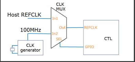

Part Number: LMKDB1202
Could you please advise how long it takes after enabling SRIS on the clock generator to switch to In2 via the CLKIN_SEL_tri pin (pin 7) of the MUX?
How much delay is required in between? Thank you.

Hello Jeff,
70ns max.
Vicente
Hello Jeff,
this spec is defined as the maximum time it takes to switch between 100MHz clocks in other words the time it takes to switch Inputs via MUX between a 100MHz clocks at CLKin1 vs CLKin2 or vice versa.
Vicente
