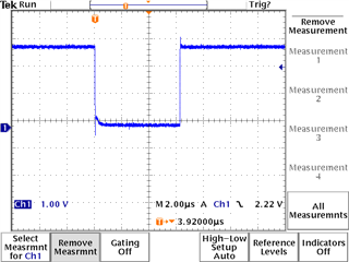

Hi team,

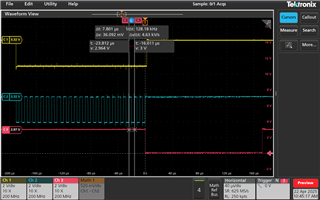

My customer is evaluating LMX2820 and the loop filter parameters are based on the LMX2820EVM default values (C1=470pF, C2=68nF, C3=2.2nF, R2=68.1Ω, R3=18.2Ω)..
the simulated result shows a Lock Time of approximately 88 µs, including the impact of VCO calibration.
However, in customer HW measurement, the time from SPI transmission completion (CS# goes high) to LD (Lock Detect) pin transition from LOW to HIGH, and it is approximately 171 µs.
customer would like to confirm,
  1. Is measuring the Lock Time based on LD falling and then rising edge a recommended and reasonable method?
  2. If we would like to achieve a faster Lock Time (e.g., close to the 88 µs simulation result), would it require specific hardware settings (such as enabling Fast Mode or Instant Calibration)?
  3. Could you kindly advise the appropriate hardware configuration to achieve closer alignment with the simulated results?

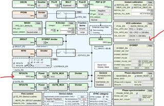

Can we shoe customer how to evaluate the locking time?  and below are additional questions from customers.
  1. The Lock time includes VCO calibration time and analog lock time, am I right ? So the method is only to reduce VCO calibration time, analog lock time depends on hardware loop filter.
  2. Faster lock setting? GUI set? (as below 4.3 state)
  3. Can we just check LD pin for total Lock time for LMX2820 to lock? How GUI start to initiate both VCO calibration and frequency change for check total lock time?

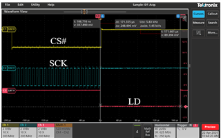

  • Hi Eddie,
    How many registers did you program during the lock time test? How fast were you writing the register?
  • Hi Noel,
    Customer use TI’s LMX2820 EVB and press Calibrate VCO button in GUI. If change frequency then press Enter, the total program time too long and not good to check lock time. Customer need our suggestion how to test the fast lock time through TI’s EVB and how to configure LMX2820 to do fast lock.
    SPI clock: ~128KHz

  • Hi Eddie,
    Total lock time = programming time + calibration time + analog lock time.
    Right, analog lock time is proportional to the loop filter design.
    User can shorten the programming time with higher SPI speed.
    In LMX2820, calibration time can be eliminated with the InstCal feature.
    To use this feature, a one-time calibration is required. After that, changing frequency will not do calibration anymore.
    Below is the procedure to use InstCal.
    Initialization register setting
    1. Set DBLBUF_PLL_EN, DBLBUF_CHDIV_EN, DBLBUF_OUTBUF_EN, DBLBUF_OUTMUX_EN = 1
    2. Set DBLR_CAL_EN = 0; INSTCAL_SKIP_ACAL = 0
    3. If VCO doubler is required, set INSTCAL_DBLR_EN = 1, otherwise set this bit to 0
    4. Set INSTCAL_DLY = T x fosc (in MHz) / 2^CAL_CLK_DIV, where T = 2.5 x CBIASVCO / 0.47µF. CBIASVCO is the bypass capacitor at pin 3
    5. Configure other registers to lock to 5.65GHz without any calibration assist
    6. Set INSTCAL_PLL_NUM = 2^32 x (PLL_NUM / PLL_DEN)
    Programming
    7. Vcc power up LMX2820
    8. Program all the registers, LMX2820 should lock to 5.65GHz
    InstCal calibration
    9. Program INSTCAL_EN = 1
    9.5 run Index routine
    10. Program R0 (with FCAL = 1), calibration will begin
    11. Wait 100ms
    12. Program R0 (with FCAL = 0) to complete the calibration
    13. If LD pin did not turn HIGH, program RESET = 1 to reset LMX2820. After LMX2820 is reset, repeat Step 8 to 12
    Changing VCO frequency
    14. Program INSTCAL_PLL_NUM, PLL_N, PLL_NUM and PLL_DEN (if their value have change)
    15. Program R0 (with FCAL = 0) to change VCO frequency
    9.5 Index routine
    1. Program R106[10] = 1 (0X6A 0400)
    2. Program R107[5:0] = 0 (0x6B 0000)
    3. Program R108 = 0 (0x6C 0000)
    4. Program R109 = 0 (0x6D 0000)
    5. Program R106[9:0] = 514 (0x6A 0602)
    6. Program R106[11] = 1 (0x6A 0E02)
    7. Program R106[11] = 0 (0x6A 0602)
    8. Repeat step 5 to 7 for R106[9:0] = 515 to 519
    9. Program R106[10] = 0 (0x6A 0207)

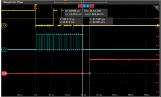

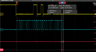

  • Hi Noel,

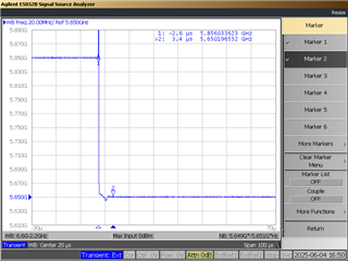

    Is there locking time difference between the hopping frequency range? customer did some experiment if the hopping frequency is less than 100MHz the locking time can support 7uS. but if hopping frequency range large than 100Mhz and locking time will increase to 37uS.
    Is any solution can improve locking time with hopping frequency range large than 100MHz?
    below hopping frequency large than 100MHz
    and below hopping frequency less than 100Mhz.
    Thanks & Regards
    Eddie
  • Hi Eddie,
    Are the plots taken using InstCal?
    What is the target lock time?
  • Hi Noel,
    Yes, customer use Instant Calibration(InstCal)mode for testing.
    The target locking time is less than 10us and if the hopping range less than 100Mhz locking time is  around 7 ~ 8us but if hopping range large than 100MHz ( Ex. 5650Mhz ~ 5800MHz) locking time will increase to 32 ~ 37us.
    customer have questions below,
    1. The locking time 7~30uS is within our spec. ? any measurement method can suggest for customer?
    2. for large range hopping, is there any register setting can help increase the locking time?
    Thanks & Regards
    Eddie

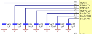

  • Hi Eddie,
    In general, 10µs is possible for any frequency change. You may need to scarify some phase noise for faster frequency switching.
    C29 should be 470nF or less. C31 should be less than 10µF.
    Loop bandwidth should be wide enough to reduce PLL analog lock time. The bandwidth should be above 100kHz.
    Your test result (1st plot) does not look right to me, LD should remain HIGH before R0 programming is complete, just like the second plot. Did you check all the doubler buffer enable bits?

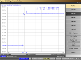

  • Hi Noel,
    Customer use our EVM without change components value,  below are some experiment use Instant Calibration mode,
    Step1:enable Instant Calibration mode, set output 5650 MHz,。
      • load register value as attached, " Step1_5650mhz.txt"
    Step2:change output frequency to 5850 MHz(+200 MHz hopping)。
      • LD pin change from  HIGH to LOW, PLL  unlock 。
      • load register as  "Step2_5650mhzto5850mhz.txt"
    Step3:Toggle FCAL and  LD come back to HIGH. 。
      • Measured LD from LOW → HIGH is around 30 µs。
      • the register setting is " Step3_5850mhzcal.txt"
    Questions from customer,
    1:  Do we have experience use LMX2820 frequency hopping more than 100MHz but Lock time less than 10uS?
    Can we provide example setting change from 5650MHz to 5850MHz base on our EVM?
    2. from pllatinum sim simulation lock time is 30.3uS, but from customer experiment , they can sometime get 10uS locking time but unloack sometimes.
    Is it related to parameter setting ( VCO_CAPCTRL、DACISET、VCO_SEL、INSTCAL_EN) ?
    Can you help above questions?
    Thanks & Regards
    Eddie

  • Hi Eddie,
    Here is my data, after finishing the one-time InstCal calibration, I change the frequency to 5850MHz, measure the lock time, then change the frequency to 5650MHz, measure the lock time. I use CSB pin to trigger test equipment.
    From 5850Mhz to 5650MHz:
    LD pin timing same as PNA.
    From 5650MHz to 5850MHz:
    LD pin timing.
    To change the frequency, simply type the frequency you want in RFOUTA box. Output frequency will not change because double buffering is enabled. Then click the Calibrate VCO button (this will program R0) to change the frequency.
