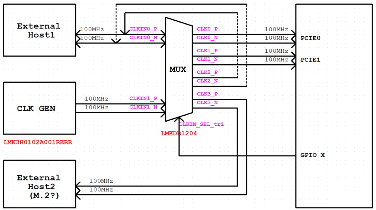

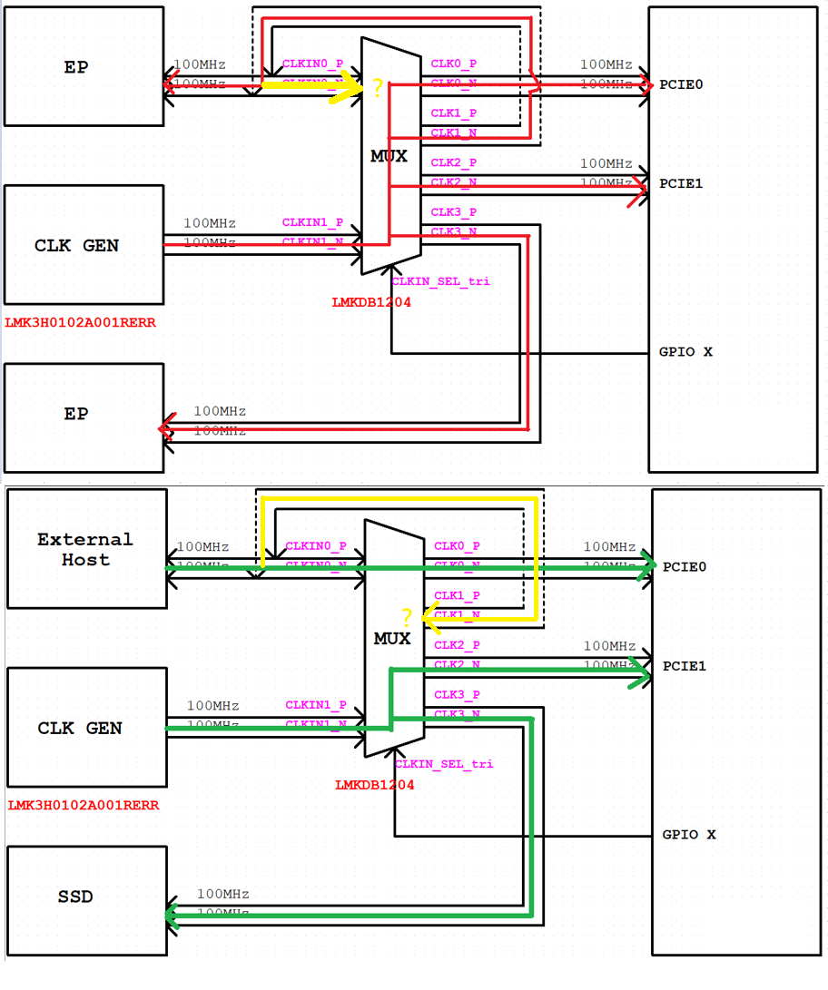

If we apply the LMK3H0102A001RERR + LMKDB1204REXR in the following block diagram.
Would you please help verify if the block diagram and truth table below are correct. Thank you.
CLKIN_SEL_tri |
OE0# |
OE1# |
OE2# |
OE3# |
MUX Input |
MUX Output |
Host Mode |
HIGH |
GND |
GND |
GND |
GND |
CLKIN1 |
CLK0/CLK1/CLK2/CLK3 |
8L Common Mode (Device mode 1) |
LOW |
GND |
GND |
H or X |
H or X |
CLKIN0 |
CLK0/CLK1 |
8L SRIS Mode (Device mode 2) |
HIGH |
GND |
GND |
H or X |
H or X |
CLKIN1 |
CLK0/CLK1 |
