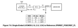

  • Hi Wu,
    It should not exceed 2.6V. If you're using 3.3V LVCMOS, you can add a voltage divider as shown here:
    -Riley
