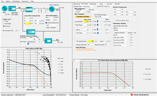

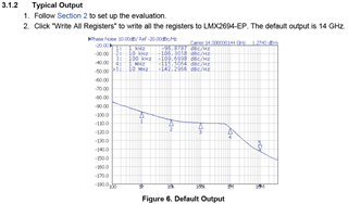

(1) Regarding the results listed in Figure 6 of the evaluation board PDF (snau245.pdf).
 I understand that the results in Figure 6 are obtained according to what is listed in Table 1. I also understand that the LoopFilter constants on the factory evaluation board are also the values listed in Table 1.
However, when I perform the design under the same conditions with your Sim software PLLatinum Sim, the LoopFilter constants show different values.
I would like to know the cause of this difference and the correct sim method (loop filter design method) to match the results of the evaluation board.

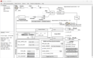

(2) In order to obtain the data described in Fig. 6, should I set up TICS Pro as shown in the following image?

  • Hi Naohiro-san,

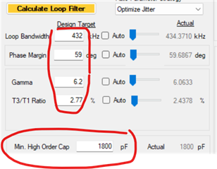

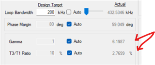

    Your design target is 430kHz but the actual is 332.7kHz, so the loop filter is different from EVM default.
    This is because you haven't set the target for Gamma and T3/T1 ratio.
    EVM default:
    Set the same value as your target:
    Then you will get the loop filter very similar to EVM.

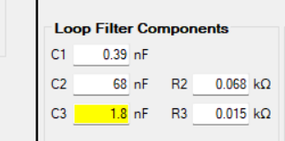

    (1) I apologize for my lack of understanding, but could you please explain what the Gamma parameter and the T3/T1 parameter represent?
    (2) When I set the parameters as you suggested, the simulation shows C1 as 0.39pF, but the datasheet lists C1LF as 0.47nF (470pF). Additionally, R3 in the
    simulation is 15Ω, while the datasheet shows R4LF as 18Ω. Could you please explain the reason for these discrepancies?

  • Hi Naohiro-san,
    This is a 3rd order loop filter, so there are three poles, T1, T2 and T3.
    T3/T1 is the ratio of the pole T3 to the pole T1. Higher percentage means higher attenuation. As a result, higher loop bandwidth is not possible.
    Gamma = 1 yields max. phase margin at the loop bandwidth. If you want fast lock time, make this close to 1. Higher Gamma may produce a flatter inband respond but increase lock time.
    390pF vs 470pF and 15Ω vs 18Ω literally has no obvious effect on the loop characteristic. Simulation provides suggested values, actual implementation picks the closest market available values.
    You will get Figure 6 result if you use the "Default Configuration" from TICS Pro.
    Your configuration modified some configurations but it is fine, you should get the same result as Figure 6.
    Please note, Figure 6 was taken with a very low noise reference clock. Suggested clock source are Wenzel OCXO or SMA100B.

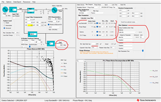

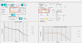

  • Hi Noel Fung.
    I have an additional question, which I would like to ask you to answer together with the above question.
    I have found the Loop Filter at 8001GHz using PLLatinum.
    The constants are shown in the image below.
    When I changed the constants on the evaluation board to be the same as the sim result based on this result, the phase noise was different from the sim result as shown in the image below.
    I would like to know the cause of this difference.
  • Hi Naohiro-san,
    We have a PLL Sim training video in below link.
    https://www.ti.com/video/6330930382112?keyMatch=pllatinum%20sim&tisearch=universal_search
    Better SNR means lower phase noise or jitter. Usually a wider loop bandwidth + higher phase margin can return lower jitter.
    We can manually type the four target parameters and click the Calculate Loop Filter button to get the suggested values and actual loop performance.
    We can uncheck the boxes and move the slide bar to quickly see the effect.
    We can also provide a target jitter to the tool, it will come up with the best possible configuration for us.
    The video has the details.
    Your plot shown the loop bandwidth is just 50kHz with a small phase margin. Likely this is due to wrong component values are populated.

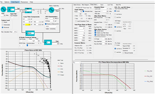

  • Hi Noel Fung.
    Thank you for your reply.
    I understood that the jitter parameter is the most effective for SNR.

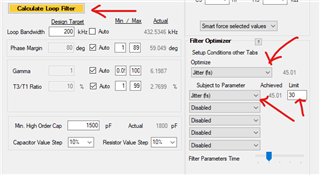

    Based on the results of the training video, I further increased the phase margin and loop bandwidth from 50kHz to 206kHz.

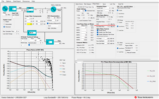

    In order to achieve good SNR, we designed the system as shown in the following image.
    The jitter parameter of Filter Otimizer is set to 30.
    Loop Bandwidth, Phase Margin, Gamma, and T3/T1 Ratio were set to Auto

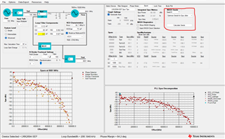

    - MASH Seeds was set to Optimize Seeds for Spur Jitter and the calculation was performed
    As a result, SNR of -49.5 dBc/Hz was obtained.

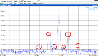

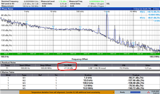

    The simulation results did not show any spurious signal, but the actual measurement results showed a 1 MHz spurious signal.
    (1)Please tell me the cause of this 1MHz spurious.
    In addition, I obtained a result of -49.5dBc/Hz for SNR with Sim, but it was -27.34dBc/Hz in the actual measurement.
    (2)Please tell me the cause of the difference between the Sim and measured results.

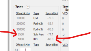

  • Hi Naohiro,
    The sim already told you there are spurs:
    With 100MHz input and 8001MHz output, for sure there will be Integer Boundary Spurs (IBS) at 1MHz. Fractional spurs is also 1MHz. Sub-fractional spurs appear at 1/2, 3/2 of fractional spurs frequency.
    The sim can predict the spurs frequency but not able to accurately predict the spurs level as this is very much depends on the chip layout. The spurs level also depends on the input clock format and level.
    You may read LMX2582 datasheet, section 8.1, for details of spurs.
    Your measurement integrated all the noise between 100Hz and 100MHz, including the spurs, so the jitter and SNR is bad. If you omit spurs in your measurement, you should get SNR close to simulation.
    To reduce this spurs, use smaller charge pump current, use square wave input clock, use a weird PLL NUM such as 10000001.

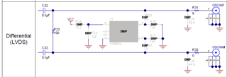

    (1) Is it possible to input LVPECL signal format?
    Is it possible to input LVPECL signals or only LVDS?
    (2) Is it possible to input differential signals directly to the factory evaluation board? Is there anything we need to change on our end?
    Please answer the above two questions.
  • Hi Naohiro-san,
    Both LVDS and LVPECL are acceptable.
    The eval board is default to single-ended input, you need to modify it for differential input. See EVM user's guide for details.
    If the input is LVPECL, the modification is same as above diagram except that R31 and R32 should be 0.1µF capacitor.

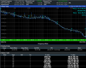

  • Hi Noel Fung.
    By using LVPECL as input, the integrated C/N value has improved.
    Thank you very much.
    Question 1) Please tell me why spurious improves with differential signal input.
    Question 2) In TI PLLatinum, when I try to analyze up to kHzOrder like 7689.33MHz, my PC gets stuck. Please tell me a simple method to derive an approximate value.
  • Hi Naohiro-san,
    1. Spurs are due to modulation to the VCO, the modulation signals come from different paths. The mechanism of modulation signal generation is complex and tricky. I believe any non-linearity, mismatch or offset create the modulation signals. Our observation is that a differential square wave reference clock tends to return less spurs.
    2. this happen very often if we enable spurs in PLL Sim. this is due to extensive calculation for spurs in the background. It will show "not responding" but in fact it is still running. If you can wait for some time, it will resume to normal after all calibrations are done.

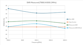

  • Hi Noel Fung.
    I understood that differential signals tend to be better for spurious, and that the clear mechanism is complex and not obvious.
    I have a question about Sim and actual measurement in 0.1 MHz increments.
    Sim and actual measurements were made at 7999.9MHz~8001.1MHz. The measurement results are as follows.
    The signal used for the measurement was the LVPECL signal.
    The following are the measurement results at CP15mA.
    The following are the measurement results at CP3mA.
    Ideally, we would like to achieve -46dBc/Hz or less.
    Can this result be any better?
  • Hi Naohiro-san,
    With 100kHz step, for sure there will be spurs at multiples of 100kHz offset.
    Reducing charge pump current can reduce the spurs level. However, the loop bandwidth will also be reduced. As a result, inband noise will be higher.
    We could also try using different order MASH. Third or forth order MASH, in general, can randomize spurs better but also increase phase noise.
    We may try 4th order loop filter, hopefully can provide some degree of spurs reduction.
    We may also play around the PFD_DLY_SEL register to optimize phase noise.
    We can also try using a bigger PLL_DEN such as 10000001.
    In short, it is more or less a trial and error fashion to optimize overall phase noise or SNR.
