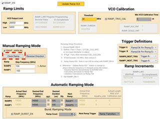

Customer is evaluating LMX2595EVM.
automatic ramping mode is tested but when customer tried to test manual ramping mode, it doesn't work.
Please check below GUI setting.
Thanks.
Thanks.

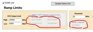

Hi David,
Looks like you are using EVM default configuration, then there should be no issue with manual ramp.
Make sure you have click the Update Ramp GUI button before enabling ramp.
Also make sure the hardware has RampClk and RampDir connected to the device.
