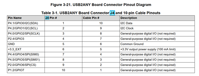

    (1) we prefer to use USB2ANY to control LMK3H0102,  is the I2C signal level 3.3V and already pull-up at USB2ANY?
    (2) In above case, if I don't  want to add extra level shift, the only VDD option  of LMK3H0102 is 3.3V? Is my understanding correct?

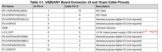

    (3) regarding connection interface to USB2ANY (like J4 in SNAU287 EVM guide), please help to confirm that
    (3.1) I only need  I2C_SDA, I2C_SCL, GND.
    (3.2) +3.3_EXT, GPIO2, GPIO3, GPIO4, GPIO5, GPIO6, GPIO7 are not required in any case like attached table.

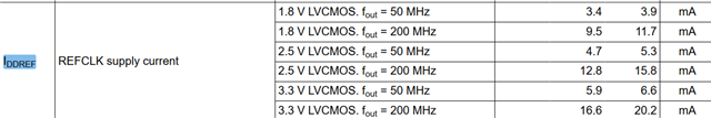

    (5) Regarding IDDREF in datasheet, does it belong to VDD or VDDO?
    Yes the USB2ANY operates at 3.3V and has internal pullups for the SDA/SCL lines. Though it is best practice to include depopulated pullup resistors for debug purposes.
    Correct, the SDA/SCL lines require 3.3V
    Correct
    Correct. The USB2ANY uses the USB/Computer connection to supply the 3.3V. The rest of the GPIO pins can but used but are not required for I2C communication

    (5) Regarding IDDREF in datasheet, does it belong to which domain VDD or VDDO?
  • Tim,
    CLK_READY is feasible for driving a <5mA load. The driver during CLK_READY operation is the same as the one during LVCMOS clock operation for this pin.
    IDDREF is sourced from the VDD domain.
