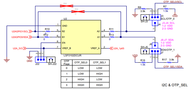

LMK3H0102EVM: question about LSF0102DCUR design in LMK3H0102EVM
Part Number: LMK3H0102EVM
Other Parts Discussed in Thread: LMK3H0102, LSF0102
Hi Support
Regarding the level shift  LSF0102DCUR that is taken from SNAU287 ( LMK3H0102 Evaluation Module  user guide)

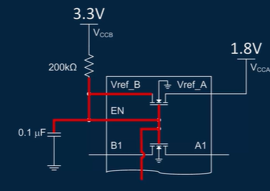

According to LSF0102 datasheet, I wonder there should be a 200 KOhm resistor when  connecting power to VERF_B and EN.
But there is no such 200 kOhm in the SNAU287 ( LMK3H0102 Evaluation Module  user guide). Could you please double check?
