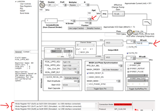

if i want to set frequency in a resolution of 500KHz Step, Can i use the Table as it provided below in the document
Streamline RF Synthesizer VCO Calibration and Optimize
PLL Lock Time
if i want to change from 7500MHz to 7500.5MHz but by using 7500000KHz to 7500500
can i use same formulas? as when we change in MHz resolution?
do i need to use more registers than the below that i use? is the writing order important?
Is my writing order below ok?
should i add more registers for accuracy ?
here is my writing for 7500000 by writing order
0x4E00A4      (reg_78d)
0x2B0000       (reg_43d)     should i add writing to 2A (reg_42d)?
0x270001       (reg_39d)      should i add writing to 26 (reg_38d)?
0x250304       (reg_37d)
0x24004B       (reg_36d)   should i add writing to 22 (reg_34d)?
0x14C848       (reg_20d)
0x11012B       (reg_17d)
0x00241C       (reg_0d)
here is my writing for 7500500 by writing order
0x4E00A4
0x2B0001         (reg_43d)     should i add writing to 2A (reg_42d)?
0x2700C8          (reg_39d)      should i add writing to 26 (reg_38d)?
0x250304
0x14C848
0x11012B
0x00241C

    Suggest install TICS Pro to help you develop the software.
    For example, with below configuration, to change the frequency from 7500MHz to 7500.5MHz, only the PLL_NUM has to update.

    i just wonder if my order of writing registers is ok and what i will need a better resolution, for example 1 khz, i.e. what is the highest resolution i can achive while using the above registers. would i have to add additonal registers and when ? if i need to change a 1 khz or 100 hz etc.
  • Hi Arye,
    resolution = fpd / PLL_DEN.
    to change the frequency, write to those related registers, programing sequence or order is not matter but the last register to write should be R0 (with FCAL_EN = 1) .
