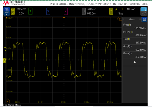

I am using LMK1D1204 IC in my design as below
SG3225's output clock is measured and seems to be ok.
But output clock of the LMK buffer seems to be non-monotonic and looks worser with diff probe as well.
Measurement with Single ended probe on 'P' and Ground clip connected to board ground
Measurement with diff probe between 'P' and 'N'
Can you pls tell me what can be done to tune them?
The clock outputs from LMK buffer go to Virtex Ultrascale+ FPGA where we use DIFF_SSTL12 Standard.
