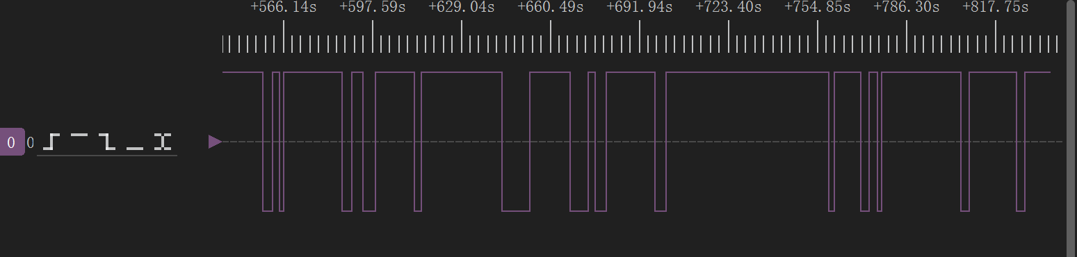

I am currently trying to synchronize the PTP clock output from an Aes67 audio device using Intel i210. The reference clock output from i210 is then filtered/multiplied by LMK05318B to output an I2S clock to downstream devices.
The i210 is controlled by an x86 Linux PC and synchronizes the external clock through Linux's PTP4L. The testPTP program controls the i210's SDP pin to output a 2KHz square wave signal as the reference clock for LMK05318B. The XO crystal oscillator of LMK05318B is a 12.288M TCXO
The PCB used for testing was drawn by myself, and the register configuration currently used for testing is as follows:

    Add some additional information:
    When ptp4l is not yet running, it can be observed that LOPL-DPLL is in a cleared state for a considerable amount of time. The following figure shows the status pin signal collected by me using a logic analyzer when set to LOPL output in this state (duration of about 5 minutes):
    Once ptp4l is started to synchronize the network card clock to the external clock, LOPL-DPLL will remain in a marked state unless the lock and unlock thresholds in DPLL phase lock detection are increased

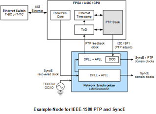

  • Hi Link,
    To add to Octo's comment, it would be helpful if you can provide a block diagram of the setup, something like this is what I've seen for PTP:

  • It is possible to lock without running PTP4L, but there may be occasional loss of lock (LOPL_SPLL cleared after being briefly marked).
    One of my devices has a noticeable jitter in the PTP clock output, and you can see that the RMS value changes frequently.

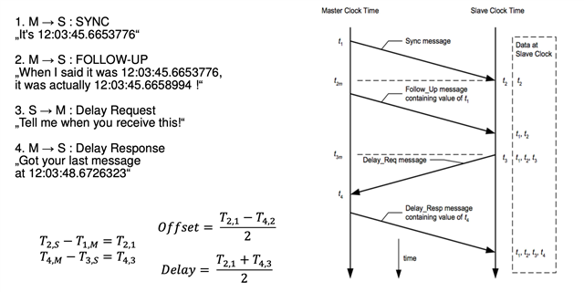

  • The intrinsic jitter in rms value fluctuation is normally around 10-100ns with PTPv2. Maybe slightly lower.
    With 1000BASE-T link capability, the i210 has a core clock of 125MHz (125Mbaud 5-level coded PAM signaling)
    and thus 8ns timestamping and trigger steps. Adjustment (i210 TIMINCA register) is done in resolution of 2-32 nS but that is by calculation/interpolation, aka pulse skipping.
    I wish to share my test with you to have practical numbers.

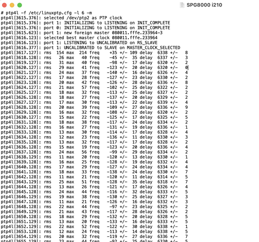

    Running a test with ptp disciplined i210 PPS out on SDP pin as 1Hz reference for LMK05318B.
    These are numbers from todays testrun in broadcast production environment.
    Telestream SPG8000 GM (GPS locked) -> Arista switch BC-> Netgear AV switch BC -> i210 PPS -> LMK05318B
    #ptp4l -f /etc/linuxptp.cfg -l 6 -m

    ptp4l[561.913]: rms  159 max  196 freq   +128 +/- 102 delay  1961 +/-  10
    ptp4l[562.912]: rms   53 max   82 freq   +114 +/-  39 delay  1972 +/-   5
    ptp4l[563.912]: rms   46 max   82 freq    +59 +/-  63 delay  1967 +/-   7
    ptp4l[564.921]: rms   44 max   85 freq    +32 +/-  58 delay  1975 +/-   4

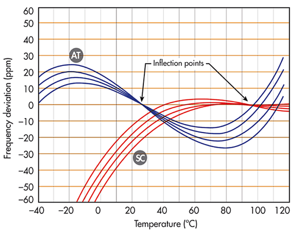

  • SC-cut crystal in the OCXO has a frequency deviation of 20 - 30 ppm during warming up.
    With XO=24,576MHz ±0.1 ppm and GPS reference 1PPS.
    I calculated an allowed error between REF and XO of about 2,56 ppm.
    That explains the slow initial locking in my case. With and without softreset it works fine after warming up.
    Described at datasheet LMK05318B-Q1 "8.1.4 Slow or Delayed XO Start-Up"

  • I will use LMK software reset after configuration, and if burning EEPROM, it will power off and restart hard.
    In my testing process, when there are non PTP packets (which is a daily usage situation), it can be seen in the output log of PTP4L that there is a sudden increase in RMS value in a short period of time:
    ptp4l[28807.082]: rms 46 max 86 freq +10130 +/- 63
    ptp4l[28808.082]: rms 62 max 95 freq +10139 +/- 86
    ptp4l[28809.081]: rms 44 max 85 freq +10173 +/- 57
    ptp4l[28810.081]: rms 56 max 86 freq +10142 +/- 76
    ptp4l[28811.081]: rms 56 max 98 freq +10162 +/- 77
    ptp4l[28812.081]: rms 39 max 72 freq +10175 +/- 53
    ptp4l[28813.081]: rms 59 max 101 freq +10157 +/- 80
    ptp4l[28814.081]: rms 48 max 112 freq +10134 +/- 63
    ptp4l[28815.081]: rms 34 max 58 freq +10124 +/- 44
    ptp4l[28816.082]: rms 33 max 65 freq +10149 +/- 44
    ptp4l[28817.081]: rms 1444 max 4016 freq +10865 +/- 1929 delay 4336 +/- 0
    ptp4l[28818.081]: rms 482 max 674 freq +9695 +/- 91
    ptp4l[28819.082]: rms 108 max 188 freq +9947 +/- 71
    ptp4l[28820.082]: rms 68 max 112 freq +10089 +/- 88
    ptp4l[28821.082]: rms 85 max 138 freq +10184 +/- 87
    ptp4l[28822.081]: rms 54 max 95 freq +10210 +/- 53
    ptp4l[28823.082]: rms 46 max 83 freq +10168 +/- 64
    ptp4l[28824.082]: rms 52 max 86 freq +10181 +/- 72
    If other types of data communication are turned off and only PTP data is available, RMS will remain relatively stable within 100, but this is not feasible in practical use scenarios.
    I have tried various ptp4l configurations, but currently, there are still situations where LMK briefly marks LOPL, with times ranging from a few hundred milliseconds to over ten seconds.
    Will this brief LOPL marking affect the stability and accuracy of the final output clock?

    Looking at the ptp4l log i see a few things.
    With this particular i210 nic, the LMK can only have stable genlock with phaselock after seeing the PTP GM because the i210 XO has a static freq offset of +10142 ppb. (10.142 ppm > 5,12 ppm alloweble error)
    The rms and peak jitter numbers doesn't look that strange. The variance can happen because of network congestion, packet reordering, asymetric delays. Or maybe a not so obvious config mistake like mixing different PTP profiles in GM or switch BC. (IEEE 1588 clause 19.3.1.1) But this outlier looks like a systematic bug. I believe that it also occurs without other traffic but less frequent, maybe once in few days. PTP is designed for timing + other traffic.
    pub.smpte.org/.../st2059-2-2021.pdf
    On the other hand the goal is to create a SMPTE ST2059 compliant PTP follower and the LMK05318B can save the day as jitter cleaner + timing flywheel.
    See also the ptp4l filtering effect with a frequency jump of 10.149->10.865->9.695->9.947 ppm while ptp glitched almost 4000ns early/late.
    ptp4l software algorithm has a pi loop with kp_exponent = -0.3, ki_exponent = -0.4.
    It would be great if the follower is (much) more imune to disruption and phasesteps than contributed time error by the switch's TC/BC. My experience is that audio is more sensitive to timing distortion than video.

    #phc_ctl eth1 freq should show around 10142 ppb with this NIC

  • If other types of data communication are turned off "refers to minimizing the transmission of other types of network data on the network, with the most important being RTP multicast protocol packets used by AES67 protocol.
    Can you check if LOFL and HOLDVR remain at 0 during the brief LOPL marking process? ”Throughout the entire operation, both LOFL and HOLDVR remain at 0

  • Hi Links,
    1: other ethernet traffic
    2: Throughout entire operation, LOFL and HOLDVR remain at 0
    good

    It looks like the ptp4l servo algorithm suffers from the varying network path delay during delay calculation.
    As part of the PTPv2 protocol, the path delay is contiuousely tracked with DELAY_REQ/DELAY_RESP packets.
    But if switch buffers adjust between DELAY_REQ and DELAY_RESP packets the outliers will happen.
    Maybe switching PTP mode BC versus TC (BoundaryClock/TransparantClock) will solve the outliers in this case.
