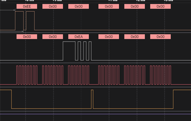

I read R110 to determine lock status.  The readback value is 0x01EA.
I am not sure where wrong,but I have this file1121.test.tcs
this is my teamMate setting , but it seem some mistake,and i am not RF expert.
i only can check the value of R110 register.
please help me find the bug ,thx

  • hello ,Noel Fung.
    But the register R110 value is 1EA that mean D10,D9=0 , it mean unlock.
    my command with spi is

  • This is my R110 register response
  • I am sure I can see the RF signal ,IF signal is 1.8Ghz and I can see the 13.3GHZ RF signal on Spectrum analysis.
    and current about 400mA, but the frequency like register data 0x1EA ,look like unstable. and drift....

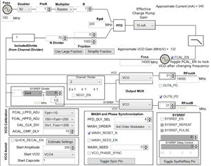

  • Hi Yan Ting,
    Based on your code, your configuration has output B powerdown and 7GHz at output A.
    MUXOUT_LD_SEL is set to lock detect output, did you measure logic HIGH at MUXout pin?
    What is the Vtune voltage? If it is locked, it should be around 1.3V.
    Can you share your schematic?

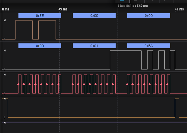

  • No, although I select MUXout of LD_SE pin, I can still get Readback signal when I give command, and its value is 0x1EA. I didn't measure Vtune voltage, but I saw it is always low in logic analysis, so I think it is just close to 0V.
  • I didn't have schematic, because this is someone design for me , I only can use software modify and test, to try function test... but when I try I found it is unstable and drift...
  • Singal like this look like unstable  and unlocked

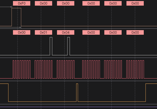

  • Th is I read R111,R112 register Value. I am sure that Vtune voltage is near 9mv and Vcal freq look like zero...
    All the data information is proove that function look like failure only  converter a high freq ....
    So I think someone give me a code only can see a high frequency converter but it drift too much,
    I can't use this to send wirelses singal ...such qpsk or each other format of wireless singal...

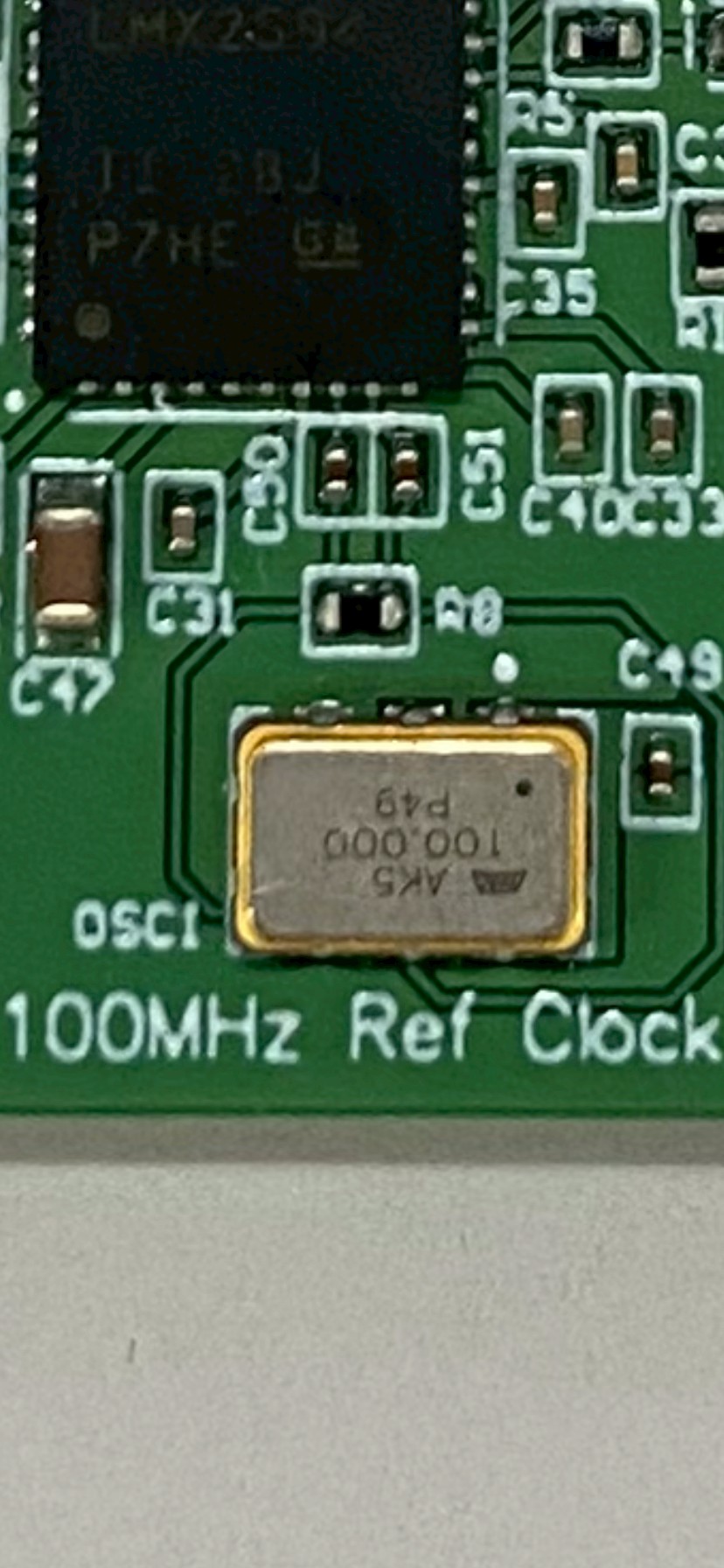

    Did you verify the 100MHz input clock? Does it look good?
  • no....seems hardware is wrong , I try you give me the code.
    and register is change 0EA from 1EA....
    I don't have any idea and clock we use this.... 100Mhz ak5
  • ask a question, if my ref clcok is not exist, do i see the IF singal up-converter to 13.3 RF singal is it possible?
  • Hi Yan Ting,
    AK5 is the reference clock, LVDS output, the connection is correct but the layout is very bad.
    If you have a differential probe, probe across resistor R8, you should get 100MHz clock with 700mVpp to 800mVpp square wave signal.
    We can program the device without a reference clock. To lock the PLL/VCO needs a valid reference clock, otherwise there will be output but the frequency is not correct.
  • I try to measure use osc with r8 , but I seem only see 1.2 voltage and not like square wave , maybe clock is didn't work... so I think that pll no locked maybe is no ref clock. But it still up converter...
