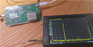

hello everyone.
I have design a pcb board use lmx2592 to generate signal.
Is lmx2592 pin compatiable with lmx2594??
In same PCB,the output frequency of  LMX2592 is accurate.But the output freq of LMX2594 have  bigfrequency deviations.
and the deviations is not fixed.
for example
the loop filter parameter is the same as lmx2592 which is work fine.

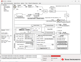

  • Hi Zhang,
    Yes, they are pin compatible.
    software are not 100% compatible, you can use TICS Pro to generate the register settings and apply it in your software. Suggested programming sequence:
    1. Vcc power
    2. program RESET = 1
    3. program all the registers in descending order, the last one to program is R0 (with FCAL_EN=1).
    4. Wait 10ms and program R0 again (this step is usually not needed. this step is required only if it is unlock after step 3).
    Your LMX2594 configuration looks good.
    Since the PLL configuration are different with different devices, can you confirm the same loop filter can be applied to these devices? You can use PLL Sim (www.ti.com/.../PLLATINUMSIM-SW) to design the loop filter.

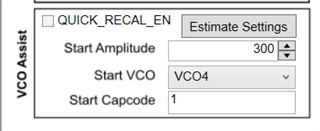

  • one more thing, suggest use below default setting.
