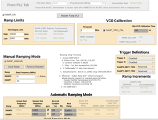

I want to see the result of Figure 28 (manual pin ramping example) of lmx2594 datasheet.
On the TICS Pro GUI,
I set the configurations as following.
And then,
when I click the 'Clock Ramp' button,
the peak move from 2.4GHz to 2.4035 GHz.
When I click the 'Clock Ramp' button again,
the peak stay on 2.4035 GHz.
But when I click the 'Clock Ramp' button once again,
the peak move from 2.4035 GHz to 2.407 GHz.
And, from this point, whenever I click the 'Clock Ramp' button,
the peak move from 2.407 GHz to 2.4035 GHz,
or from 2.4035 GHz to 2.407 GHz.
Summery,
2.4 => 2.4035 => 2.4035 <=> 2.407
What is the problem?
I want to see
2.4 => 2.4025 => 2.405 => 2.4075 => 2.41 => ...
