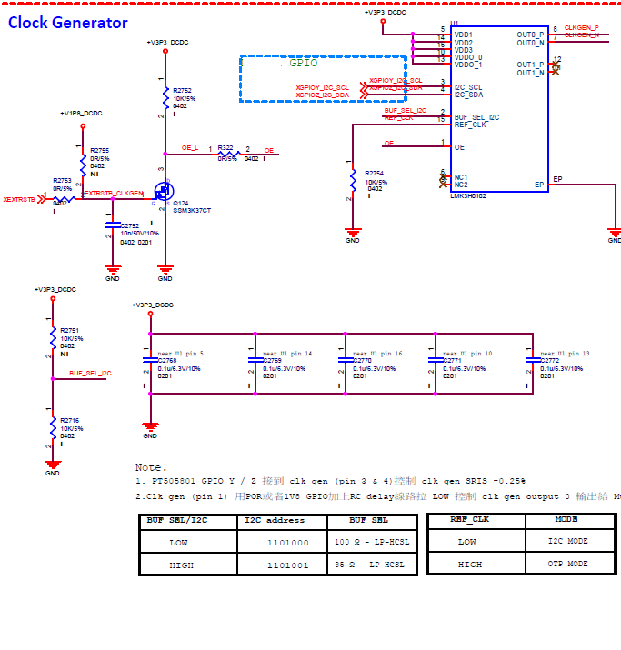

Part Number: LMK3H0102
Would you please help review below LMK3H0102 schematic. thank you.
Thanks!
Jeff

Another question,
OE# (Pin 1): The reference design uses a 3.9kΩ pull-down resistor to ground. Since this value is quite specific, we would like to ask what the internal pull-down resistance is. Can it be changed from 3.9kΩ to 10kΩ?
Thanks!
Jeff,
Ferrite beads should be used to isolate the VDD and VDDO supplies for best noise performance.
Pin 1 has an internal 75k pull-down resistor. Using 10k externally is not an issue.
Kadeem

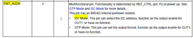

Hi Kadeem,
Curious about the reason why Pin6/Pin9 (NC pins) have output — would reserving test points for these two pins be helpful for debugging?
If IC2 Mode is selected (REF_CTRL pulled down), what is the default output impedance of the CLK GEN after power-on but before I2C communication starts? Is it 100 ohms? 85 ohms? What is the impedance tolerance? e.g., ±5%
Jeff,
These two pins (Pins 6 and 9) have no function, and can be pulled low, pulled high, or left floating.
If I2C mode is selected, the default impedance is 100-Ohm LP-HCSL. The tolerance is specified here:
Kadeem
