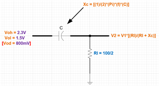

A). Analysis
The AC-Coupling Capacitor and the 100Ohm Internal Termination of the DS250F410, form an Active Voltage Divider that can be modeled as shown:
If I select C = 220pF and f = 250MHz, I get:
Xc = [(1)/(2)*(Pi)*(250MHz)*(220pF)] = 2.8937
So, V2 = V1 * [(50)/(50 + 2.8937)]
When V1 = 2.3V [Voh from LMK], then V2 = 2.174V
When V1 = 1.5V [Vol from LMK], then V2 = 1.418V
So, V2 = 2.174V - 1.418V = 756mV [Data Sheet says 760mV].
If I select C = 220pF and f = 2.5GHz, I get:
Xc = [(1)/(2)*(Pi)*(2.5GHz)*(220pF)] = 0.28937
So, V2 = V1 * [(50)/(50 + 0.2897)]
When V1 = 2.3V [Voh from LMK], then V2 = 2.287V
When V1 = 1.5V [Vol from LMK], then V2 = 1.491V
So, V2 = 2.287V - 1.491V = 796mV [Data Sheet says 510mV].
As you can see, I'm getting results that match the Data Sheet at 250MHz Output [With C = 200pF], but 'Not' at 2.5GHz!
Question: Could you provide the Math Steps used to obtain the Vod Values in the LMK04832 Data Sheet when AC-Coupling is used with a 100Ohm Termination?

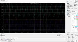

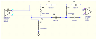

    I quick check on IBIS model gives me a VOD a bit over 800mV @2.5GHz

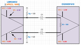

  • For AC-Coupled......the Data Sheet is showing 540mV @ 2.5GHz. That's a "Pretty" big difference from 800mV via your IBIS Model Results......wouldn't you agree? I'm thinking the Data Sheet "Typicals" are Way Off?
    From an IBIS Model Perspective, the model would be (1) Shunt 120Ohm to Ground, (1) Series Capacitor {AC-Coupled as per LMK Data Sheet} and (1) 100Ohm Shunt internal to the DS250DF410
    Could you adjust your IBIS Model to "Match" what I'm showing above {It would be "Great" if you use the DS250F410 IBIS Model}!

    Just to piggyback off of what Vicente said, in your calculations at 2.5 GHz, you characterized the output pin at 50 Ohms.
    However, in our datasheet, we state that at high frequencies (above 1.8 GHz), the pin impedance is low, and typically requires a resistive pad to bring the impedance up to 50 Ohms.

    Another thing I'm not sure of is whether not my Model is correct.
    I did "Not" take into account of the 120Ohm Shunt.
    This 120Ohm Shunt, is in "Parallel" with the Series Cap + 100/2 Termination.
    So, is your recommendation to "Ignore" the Values listed in the Data Sheet when AC-Coupling the LVPECL 1600 Outputs using 120Ohm Shunt, AC-Coupled to 100Ohm Termination?

  • Hi Dallas,
    I misread your list of calculations - the input and output pads share the same impedance characteristics, and as a result, at high frequencies, the input and output impedances are no longer 50 Ohms. However, the output impedance is not of any significance to your calculations.
    Accounting for the 120 Ohm emitter resistor as being in shunt, followed by a series cap, followed by a shunt 50 Ohm resistor to GND is the most appropriate way to model.
