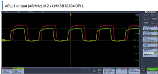

    Noted on frequency plan at APLL1 and APLL2. Will test it out. However, we needed low jitter at 48MHz because we will be using it to clock ADC, DAC and as per datasheet APPL1 output have less jitter than APLL2 output. Share your thoughts.
    Thanks for confirming on use case requirement. We will again check it out because as per current observations APPL output of multiple DPLL are in sync but at random phase difference which varies on every reboot. We have not confirmed LoFL and LoPL is locked which we will verify again.
    Please see some attached images below for your reference and request to help us understanding reasons and steps to Sync on rising edge at every reboot.

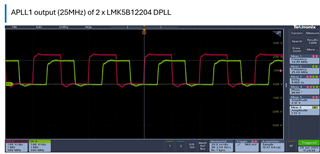

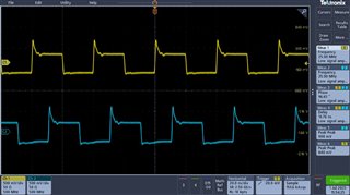

  • Hi Jennifer,
    Yes, we had verified LoFL and LoPL and still we see the offset between APLL output of two DPLL devices.
    Below two images are of APLL1 output 25MHz.
    Also, below are random phase difference we get on every power reboot.
    Power reset
    Phase
    Delay

    So, while debugging we found that on every boot, there is random delay between input 25MHz and output 25MHz. So, please let us know reason of this.
    This behavior explains why APLL output of both DPLL are not in sync even though LoPL and LoFL are locked.

    1. Can you please share your tcs file? If you only have one input coming in (25 MHz), then is the DPLL disabled? Are you using an XO input of 48 MHz with a REF input of 25 MHz?
    2. In your current setup diagram, the outputs may not have the same phase alignment. However, the outputs ARE phase synchronized to the input clock when the device is locked. When locked, the outputs have a near 0 frequency error between input and output. Also, the outputs continuously follow the input by a small fixed phase offset. This small fixed phase offset can vary across devices and across power-ups. That is why you are not seeing phase alignment between multiple devices.
    3. What it seems you want is #1 deterministic delay to ensure the same phase across power-ups and #2 zero delay to ensure phase alignment between outputs of other devices.
      1. The LMK05318B does not support deterministic delay which means multiple output phase alignment is not supported.
      2. The LMK5C2308A or LMK5B12212 does support deterministic delay. Two achieve phase alignment between multiple devices, enable the DPLL and configure ZDM on each device. Each device must synchronize to the same reference (25 MHz). With ZDM, the input-to-output phase offset is deterministic which means it can be "zeroed out" using the DPLLx_PH_OFFSET register. Once you know how much offset there is, the register can be configured such that the offset between input and output is near 0. In the LMK5B12212/LMK5C23208A TICS Pro GUI you can see that the DPLLx_PH_OFFSET register is configurable based on the time delay between input and output:
