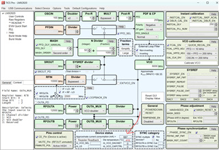

Please provide the Supply current with two RF output with VCO doubler enabled , In dataheet it is mentioned only for one output

Hi Mamatha,
Please use TICS Pro to estimate the current consumption at your configuration.
https://www.ti.com/tool/TICSPRO-SW
