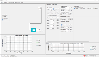

looking at the jitter specifications reported in the datasheet , the LMK1C1108 has better jitter specification than LMKDB1108 (LMK1C1108: 20fs max/8fs typ @ 156Mhz; LMKDB1108 : 31fs max/21.9fs  typ @ 156Mhz clock).

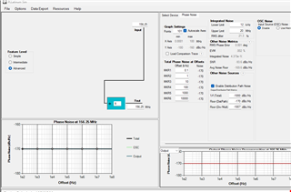

Anyway when I use the PLLatinum simulator the LMKDB1108 has slightly better phase noise and jitter than LMK1C1108 (LMKDB1108: 171.3 dBc/Hz, 28.66 rms jitter; LMK1C1108: 170 dBc/Hz, 33.29 rms jitter).
Where is the mistake ?
Paolo
  • Hello Paolo,
    Here is LMK1C @156.25MHz
    Jitter is ~21fs which matches the DS.
    When I try the same for LMKDB1108 I get the following:

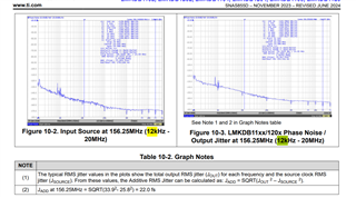

    We have a spec in the DS:
    But there is also this PN curve:
    We say 31fs maximum as reduced slew rates provide worse additive jitter.
    Unfortunately, we do not have a way to take slew rate into account inside PLLatinumSim.
    For most accurate measurements, I recommend you use the phase noise profile of the ref clk to estimate the output PN.
    With this you can also estimate additive jitter for your application.
