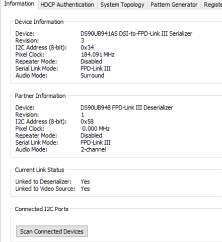

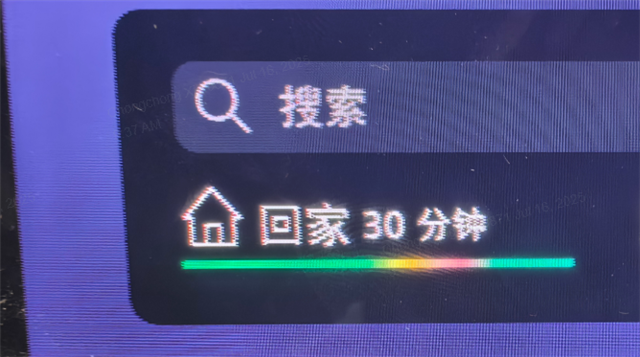

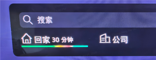

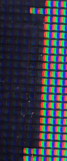

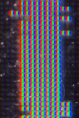

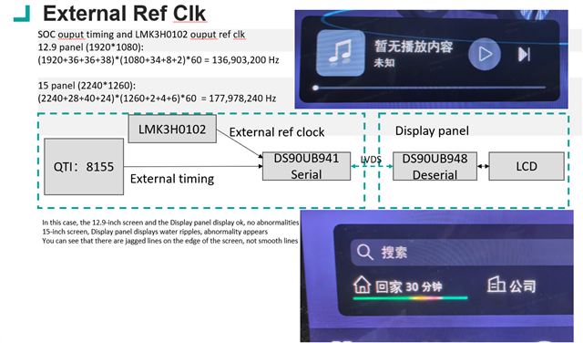

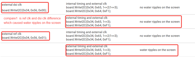

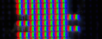

  • Hello TI:
    When we use the LMK3H0102 clock chip output to light the screen, we encounter water ripple on the 15-inch screen display screen, and the 12.9-inch screen display screen is normal.
    We have two screens in total, one is 15-inch screen, LMK3H0102 outputs 177.978240MHZ, and one is 12.9-inch small screen, LMK3H0102 outputs 136.903200MHZ. The specific register configuration of LMK3H0102 is referenced as above internal link, all provided by TI. Then the serializer is DS90UB941, the deserializer is DS90UB948,
    When investigating the problem of water ripples on the screen with 15-inch screen, the current investigation found the following:

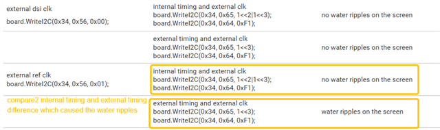

    Through the verification below, we follow the external timing and external clks used by the water ripple problem. Moreover, by adjusting the output porch value of the SOC, that is, timing or adjusting the output clks of the LMK3H0102 chip fluctuations around 177M, which will cause the water ripple phenomenon to become more serious.
    external dsi clk
    board.WriteI2C(0x34, 0x56, 0x00);
    internal timing and external clk
    board.WriteI2C(0x34, 0x65, 1<<2|1<<3);
    board.WriteI2C(0x34, 0x64, 0xF1);
    no water ripples on the screen
    board.WriteI2C(0x34, 0x65, 1<<3);
    external ref clk
    board.WriteI2C(0x34, 0x56, 0x01);

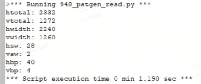

    I would like to consult the following questions:
    Question 1: There is a difference between the external reference clock and the DSI clock. What will be done internally in 941? Will it be synchronized with the DSI clock?
    Question 2: What is the difference between the external reference clock and the DSI clock? Does it depend on the DS90UB941 or the screen?
    Question 3: When 941 receives the porch value of external timing, is there a corresponding register that can be read out? If so, can I parse the porch value by reading the 941 register and compare the porch output by soc? Please provide the corresponding register?
    Question 4: There is no water ripple problem when using the 12.9-inch screen. There is no water ripple problem when using the 15-inch screen. I dumped the dsi register, normal register and remote register. At present, the difference in remote registers is quite large. Please help with comparison and analysis.

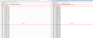

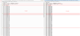

  • 12.9 panel:
    remote ds90ub948 register 15 panel:
    [REGISTERS]
    Device = ALP Nano 1 - DS90UB948, Connector 1
    Comments = "7-9-ref-clk-remote-register-dump-flick"

    remote ds90ub948 register  12.9 panel:
    [REGISTERS]
    Comments = "7-9-ref-clk-remote-register-dump-12.9-noflick"
    Date = 07/09/2025
    Time = 16:45:37

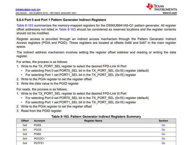

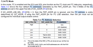

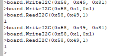

    There is NO means of accessing the I2C interface in OTP mode. This is why they are listed as two distinct modes of operation. You can start the device in EITHER I2C mode or OTP mode. You cannot switch between these without power cycling the device, with Pin 15 configured as needed prior to applying power.
    If I2C is required, start the device in I2C mode with Pin 15 pulled low. This is functionally equivalent to starting up on OTP Page 0 from a register perspective.
    I will reassign this to the proper team for the remaining questions.

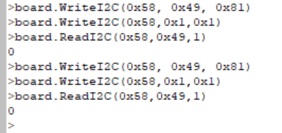

  • Hello:
    Currently, REF_CTRL is high and FMT_ADDR pin is high. Can the I2C address of the LMK3H0102 chip be read on the software? However, the I2C address is 0x68 through the TICS PRO tool. What's going on? Is it the address that OTP fixedly writes? So can this address be read by the external MCU through the I2C SCL SDA?

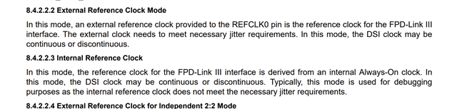

  • Question 1: There is a difference between the external reference clock and the DSI clock. What will be done internally in 941? Will it be synchronized with the DSI clock?
    The 941 can either run on the reference clock or the DSI clock. The system can run off the DSI clock but customers sometimes want to utilize the reference clock as their input for lower jitter/noise.

    Zain A
  • Yes I attached is the DES, it is different between 12.9 panel and 15 panel

    Can you find some of the main register differences between DES 948 from the 15-inch screen and 12.9-inch screen? I understand the current water ripple problem. It may be caused by the abnormal synchronization of external ref clk and external timing, but the 12.9-inch screen display is normal, so I also suspect that the screen-end deserializer configuration is different.

  • Hi:
    We use a separate screen, a DS90UB948 inside the 12.9-inch screen, and a DS90UB948 inside the 15-inch screen.
    These two are independent.
    Make our block diagram as follows
    The following is a picture showing abnormal screen with water ripples and serrated shapes:

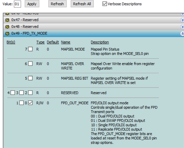

    Could you provide to me the Mode straps that the 948 is on to see what output mode you have it set on. Specifically MODE_SEL0 which controls if the odd and even output channels can be swapped.
    Zain A
  • Hello Zain:
    We are also consulting the screen supplier for information related to 948 deserializer. We cannot confirm the MODE_SEL configuration at present. You can analyze it first from the 948 register dumped in the attachment above.
    Also, please tell me if the 15-inch screen is a Sync Mode screen and the 12.9-inch screen is a DE Mode screen. Whether the serializer 941 only supports DE mode screens when using external ref clk can only be displayed normally.
    Reg 0x49 which contains the FPD_TX Mode, and currently it is set to 0x00 from your register dumps meaning it is on 00 : Dual FPD/OLDI output, so can you try writing 0x81 which would change it to the Dual SWAP FPD/OLDI output:
    board.WriteI2C(desAddr, 0x49, 0x81)
    board.WriteI2C(desAddr,0x1,0x1)
    This is for the 15 in panel 948 DES and let me know if any changes occur.
    Zain A.
  • Hello Zain:
    I have tried writing to the 15-inch screen 948 register configuration and reset, but nothing happened. The read value is still the previous value of 0.
    Judging from the values of 948 registers 0x3 and 0x6, the registers of the 15-inch screen 948 are locked and cannot be controlled through I2C pass through.
  • Hello TI
    The following is the interface connected to the 948 deserializer chip through the USB2ANY tool
    When I perform the following configuration, the display effect is a little blurry than before, but when read, the value is 0x01, not 0x81

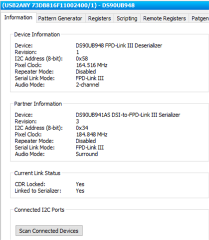

    Is there any registers for DS90UB941 that can read the timing and porch value, i want to check if DS90UB941's porch is the same with soc config.
    You can do a resolution dump with the 948 with this script here, but this only provides the Hactive and the Vactive pixels
    import time
    UB948 = 0x58
    time.sleep(1)
    board.WriteI2C(UB948,0x68,0x19) # H active High monitor
    Hhigh = board.ReadI2C(UB948, 0x69, 1)
    board.WriteI2C(UB948,0x68,0x09) # H active Low monitor
    Hlow = board.ReadI2C(UB948, 0x69, 1)
    board.WriteI2C(UB948,0x68,0x39) # V active High monitor
    Vhigh = board.ReadI2C(UB948, 0x69, 1)
    board.WriteI2C(UB948,0x68,0x29) # V active Low monitor
    Vlow = board.ReadI2C(UB948, 0x69, 1)
    mask = int('00111111',2)
    hlowmask = Hlow & mask
    hhighmask = Hhigh & mask
    vlowmask = Vlow & mask
    vhighmask = Vhigh & mask
    hhighmask = hhighmask << 6
    vhighmask = vhighmask << 6
    Hactive = hhighmask | hlowmask
    Vactive = vhighmask | vlowmask
    print Hactive ,"x", Vactive  #print out detected Dimensions
    You can also read the porch value pixels of PATGEN through these indirect registers:
    Zain A.

    This is the verification I am currently doing. Today I tried to use the 941 internal ref clk verification Internal Reference Clock Mode. Can you give me some debugging suggestions?
    Just to confirm you are still getting the same blurry effects with PATGEN enabled as well? And when you use the internal divided clock you do not get any issues, only when you utilize the external pixel clock?
    Zain A
  • This is not the case.
    When using internal timing, there is no water ripple, whether it is the external dsi clock or the ref clock.
    When using external timing, only the dsi clock is normal, and there will be water ripple when using the reference clock.

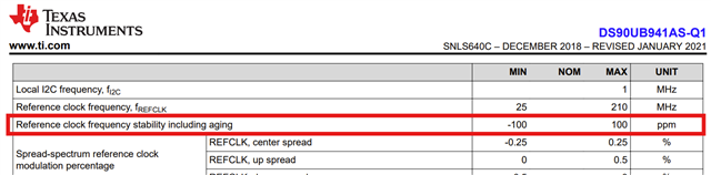

    Do you have any solutions to this problem?
    In External Reference Clock mode it is recommended that the REFCLK frequency is matched to the DSI PCLK frequency, please refer to this DSI bring up guide:
     https://www.ti.com/lit/an/snla356/snla356.pdf?ts=1753394222325&ref_url=https%253A%252F%252Fwww.ti.com%252Fproduct%252FDS90UB941AS-Q1
    Also ensure that the reference clock frequency stability is in the recommended rage as listed in the datasheet. Also are you using a Spread-spectrum reference clock? If so the spread percentage needs to also be within spec.
    Zain A
  • 1. I found the hardware to confirm that this reference clock meets the requirements, and I also turned on SSC to try to spread the frequency, but it was not effective. You don’t quite understand what the box is, what does ppm mean?
    2. I took a clearer pixel picture with my mobile phone, as shown in the figure below, like the screen parameter porch value given by the SOC configuration is the same as the screen output on the screen. Or is it because of the internal synchronization mechanism of 941, the screen is a sync mode screen. Do you know which parameter has exceptions in hfp, hbp, hsw?
    PPM stands for parts per million, and it indicates how much your crystal's frequency may deviate from the nominal value. So oscillators and other frequency control devices specify their frequency variation in units of parts per million. df = variation in Hz would be:
    Could you also clarify here? So when utilizing the external timing and reference clock, the 12.9 in screen is still okay correct? Only the 15in panel has the issue in this case?
    Zain A
  • Yes, only 15in panel has the issue. The effect of adjusting the hfp and hbp porch is this, so it is still suspected that the external clock and timing synchronization mechanism of 941 are caused.
    Because 941 does not have a register that controls timing internally, only the patgen register can control timing, so there is no problem using internal timing.
    If the same setup works fine with the 12.9 in, then it could be that the blanking pixels timing of the 15 in could be incorrect, are you sure of this timing?
