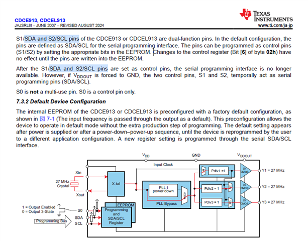

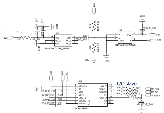

I'm trying to control a CDCE device via I2C from the main MCU, but I'm not receiving an acknowledgment (ACK) for the slave address.
I've tested two devices sourced from different suppliers. One responds with an ACK, while the other does not.
The sources are as follows:
- Procured from Chip One Stop (Japan): ACK is returned
- Procured from the TI website (China): No ACK is returned
The devices appear to have different lot numbers.
Do you have any information regarding possible version differences or changes in the CDCE device?
