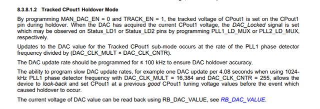

     I use LMK04832 as a PLL, I want to use the holdover function. I set   HOLDOVER_EN=1 ,  EXIT based on DLD=1 , HOLDOVER_PLL1_DETECT=1, TRACK_EN=1.  the CLK input is clk0.  when power on the pll is locked
when I remove the clk0 input,  but i found  the holdoer don't work.   if  other register need set?
  • Hello Ye,
    I believe you're using PLL1 correct?
    Please note exit based on DLD can take some time as holdover will be enabled and will wait for alignment of PLL1 R & N divider before exiting holdover.
    Sounds like from your settings your attempting the following:
    Please follow steps above for tracked CPout1 holdover.
