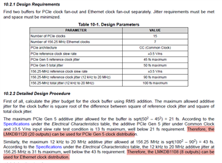

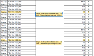

(b)
in section 6.5, under electrical characteristics as per the below the image two jitter values specified foe PCIe 5 common clock:
under what conditions slew rate become 3.5V/ns and1.5V/ns
(c)
in the above images different jitter values are specified.
what is the actual jitter value of LMKDB1108?
    The input slew rates in these cases were varied, but the output slew rate of the LMKDB1108 is configurable through SLEWRATE_SEL.
    The additive jitter value is dependent upon the input frequency and input slew rate. The typical additive jitter for a 100MHz signal with a 12kHz-20MHz BW and a 3.5V/ns slew rate is 27.3 fs.
