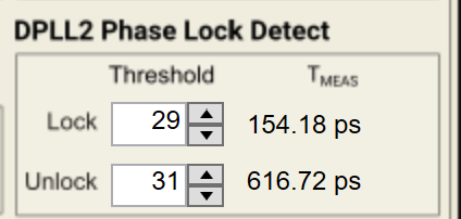

  • Yes and every time i shift signal by the same time ~40us. Here are my settings of phase lock detect?

  • Hello Piotr,
    Which output are you trying to detect the LOPL signal for? I would assume OUT10 for DPLL3.
    Looking at your configuration OUT4 is not enabled so ZDM will not be working for DPLL2 outputs.
