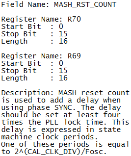

After an interval we do see this pin go high. Also confirmed that by changing MASH_RST_COUNT we can adjust the delay.

  • Hi Arun,
    Synchronization will stop after MASH_RST_COUNT is time out, we should configure this register with sufficient time to ensure synchronization can be complete before the counter is time out.
