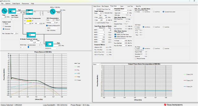

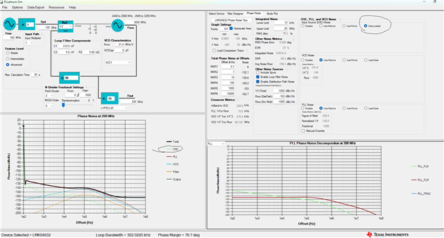

  • Hi G,

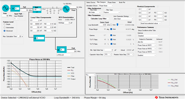

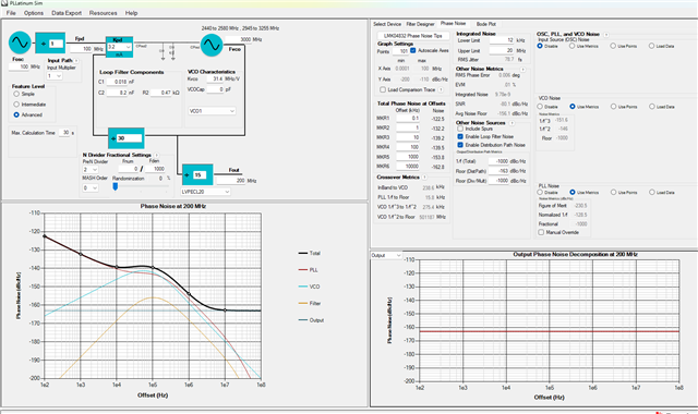

    Please use PLLatinumSim to estimate Output PN performance for these devices with their respective loop filter.
    If you have a text file of the PN for the 100MHz OCXO you can estimate output PN performance and cascade these devices.
    Ill give you can example.
    Here is the output PN for a noiseless 100MHz clock fed into LMK04832 with a 3GHz internal VCO frequency divided down to generate the 200MHz output.
    RMS jitter from 12kHz to 20MHz with this loop filter configuration is ~79fs
    We can cascade noise from the previous device which in this case is the 200MHz output from LMK04832 and load LMX2820 now and the 200MHz output from LMK04832 is now the reference clock for LMX2820.
    Doing this results in the following:
    We optimize the loop filter for the LMX2820 now and the jitter is ~70fs for a 200MHz input (from previous LMK04832 result that is now cascaded as Fosc) generating a 2GHz output.
    These are assuming a noiseless source.
    What you can actually do with in the very first step for the LMK04832 is load the input source noise.
    Now the LMK04832 is estimating the output PN with the ref clk you will be utilizing.
    This is a more accurate depiction of what to actually expect from the output PN of the LMK04832.
    You can then cascade the LMK04832 and load the LMX2820 which will use the 200MHz output from the LMK04832 as reference to the LMX2820 but now this will be a more accurate system depiction since you're including the input source noise for the LMK04832 which generates a 200MHz clock which is fed into LMX2820 to create the 2GHz clock.

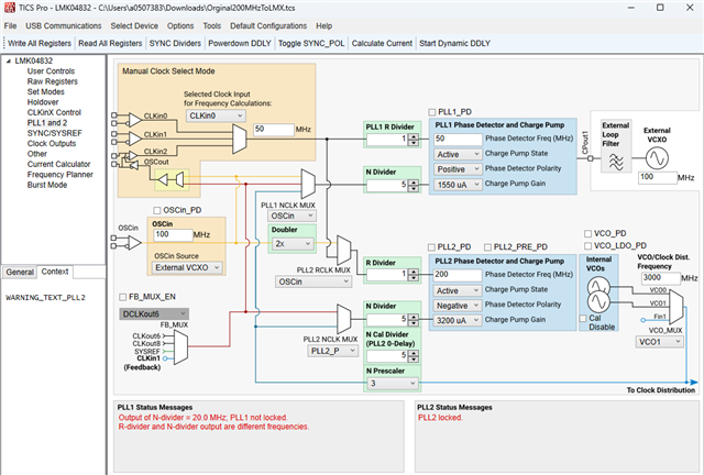

  • Vicente,
    We have successfully managed to get the LMK running providing a clean 200 MHz for the LMX with low spurs and minimum drift.
    Based on your recommendation we redid the settings/filter based on the data from the external clock and the EXVCO. We'''ll have a look at it with a jitter tester and a multigig scope on monday.
    Now, the funny thing is that the LMX is loosing lock. This is repeatable, if we send the LMK PLL1 out of lock with a different reference frequency, lets say 60 instead of 50, the LMX locks and generates the 8G and the 4G. If we send set the frequency back to 50 it will loose lock. A reboot or a recal does not help.
    Seen that before?
    We are waiting for a couple of RF probes so we can probe the 8/4G directly, but it will take another week.

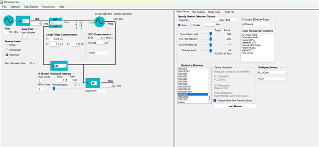

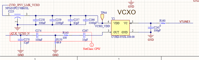

  • The setup is: An external OCXO (OH300 50Mhz) -> LMK04832 with CVHD950 VCO 100MHz and internal VCO for PLL2 3GHz divided to 200 MHz  -> LMX2820 internal VCO 8GHz
    Using PLLatinum the file LMK4830-PLL1.sim was produced with phase data from OCXO and external VCO. Using the “Cascade noise from previous device” was used to produce the PLL2 and LMX2820 files.
    It seems using different versions of PLLatinum gives inconsistent results and crashes. These files are made from version 1.6.9.0
    Sometimes the Phase noise window shows a jump from positive dbc/hz values to negative at lower offsets:
    The concern is if this affects the calculated jitter?

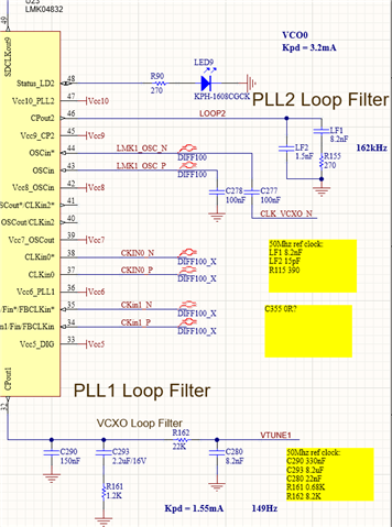

  • We working on several different loop filters, as we are getting different results using the PLLatinum sw.
    We will also bring in a FSW tomorrow, it's better than the FSQ for phase noise. Included is the design file for the LMK and the design for the LMK. Now, we do not use the external oscillator for PLL2, as the recommended part is impossible to source. So Clk1 is not in use.

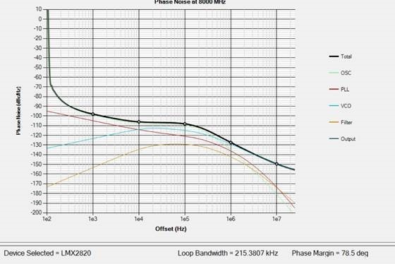

  • So we used a FSVA3030 with low jitter reference in order to do these measurements
    System ref clock. Jitter 153 fs
    LMK 50 MHz. Jitter 169
    LMK 200 MHz. Jitter 196 (Same clock that feeds LMX)
    And finally LMX 4 GHz. Jitter 180
    Is it possible to achieve 50 fs with the LMX?
    In order to measure the 4G we removed the in circuit BP filter and soldered in a 1m coaxial cable. We attached a 4 dB attenuator cable.
    Interestingly, we had to use RBW of 2Hz in order to measure, if we went to 1 Hz the signal dropped 30 dB.
    We measured 10,100,500,1000,2000 Hz

    Can you upload your most up to date schematic? I would like to review the loop filter with the current components.
    May I ask which values you recommend using our setup? For the LMK
    On the customer EVM? Schematic and BOM can be found here: LMK04832EVM User’s Guide (Rev. A)
    On the reference design I am not sure which one you're referring to, but nevertheless you would need to reach out to the team who made the reference design.
    Vicente
  • Hi Geir,
    I took a look over the TICS Pro configuration you sent, and it appears your device was not locking.
    This may explain the behavior you were seeing. I have attached an updated configuration that set the PLL1 N Divider appropriately.
    Updated200MHztoLMX.tcs
    I also took a look at the PLLatinum Sim output for this new file. I calculated the PLL1 loop filter values for a loop bandwidth of 48Hz (in the optimal range for jitter cleaning).
    I did the same thing for PLL2 - this time calculating PLL2 loop filter values for a bandwidth of 300kHz.
    Please use the updated configuration file, and try using these loop filter values.
    Michael
