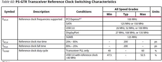

Hi Teams,
I was wondering if teams could kindly help me suggest the solution for the OSC requirement below:
  1. LVCMOS 33.3333MHz
  • -RMS jitter:<3ps
  • -Period jitter:<50ps
  • -duty cycle:45~55%
  • -rising/falling time:<2.22ns
  • -33.33MHz
  1. LVDS/CML/HCSL
  • (1)125MHz
  • (2) 150MHz
  • (3)27MHz
  • (4)300MHz
