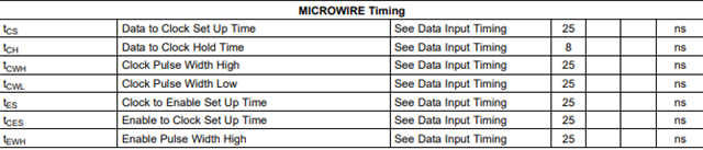

What is the minimum duration required in order to communicate SPI after 3.3V power up?
Austin
Hi Austin,
The minimum required duration to communicate with the device via SPI is 25ns (t_CES).

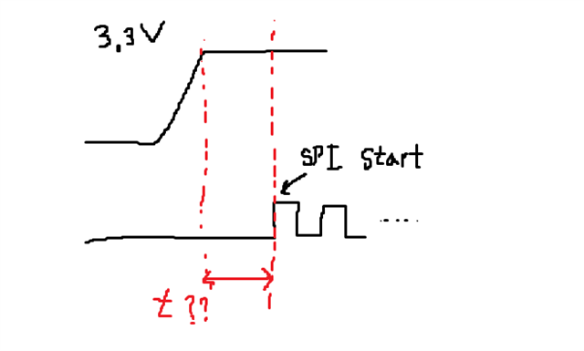

Can you explain more detail about the specification related to minimum duration?
My question was minimum duration for SPI communication after power-up.
After 3.3V supply is stable, what is the minimum time required before communication of SPI?
Austin
Hi Austin,
I understand your question better now. Unfortunately, no such specification was characterized for the LMK01010. The time necessary to wait is the time it takes for the VCC line to stabilize - this depends on your power supply, but a reasonable assumption would be on the order of about 10ms.

So, that kind of characterization is not done for LMK01010. Is 10ms typical for clock buffers?
Is it possible to add this specification?
Austin
Hi Austin,
The 10ms figure I gave you is not typical of clock buffers, per se. It is more a reflection of the typical rise time and settling time for a standard power supply. Furthermore, the 10ms figure I provided is a rough estimate - simply the amount of time I would suggest waiting.
