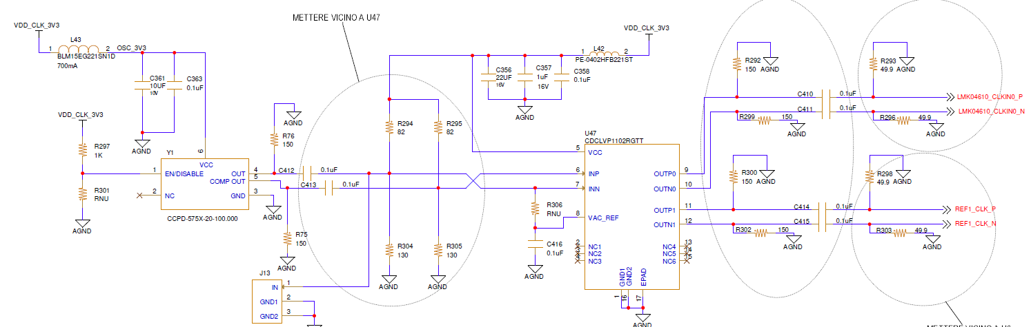

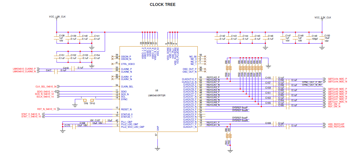

i'm using the clock distributor LMK04610 for a new project.
In the following picture there is the electrical schematic that i devoloped for the reference clock distribution from the LVPECL 100 MHz oscillator to LMK04610:

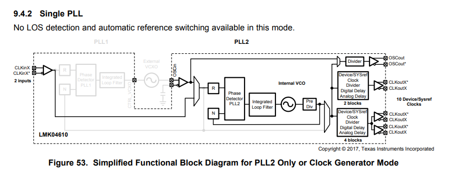

In particular, the LMK04610 must work in single PLL mode (PLL1 bypass and no external VCXO):
From the 100 MHz LVPECL input, the outputs are at 400 MHz for the CLKOUT10,CLKOUT8, CLKOUT7, CLKOUT6, CLKOUT5 and CLKOUT1. The CLKOUT2, CLKOUT4 and CLKOUT9 are at 1.5625 MHz.

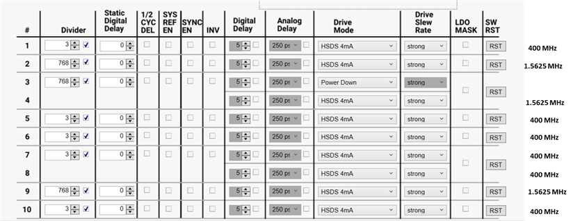

    1) Your clock tree is infeasible as-is. There are output groups of 2 that cannot output multiple frequencies - there is one divider per group. For example, CLKout0 and 1 have one divider, 2&3, 4&5, 6&7, etc. You cannot output 400MHz from CLKout8 and 1.5625MHz from CLKout9. You will have to re-arrange your outputs accordingly.

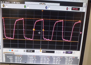

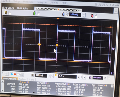

  • Hi Michael,
    with the attached registers and after pressing Device Start on the EVB, i measured the 400 MHz on CLKOUT8 and 1.5625 MHz on CLKOUT9:
    I don't understand why you don't see the same output signals.
    Furthermore, this is my LMK output configuration:
    So the outputs with the same divider are only 3&4 and 7&8.
    Waiting to hear from you again,
    Matteo Ricci
