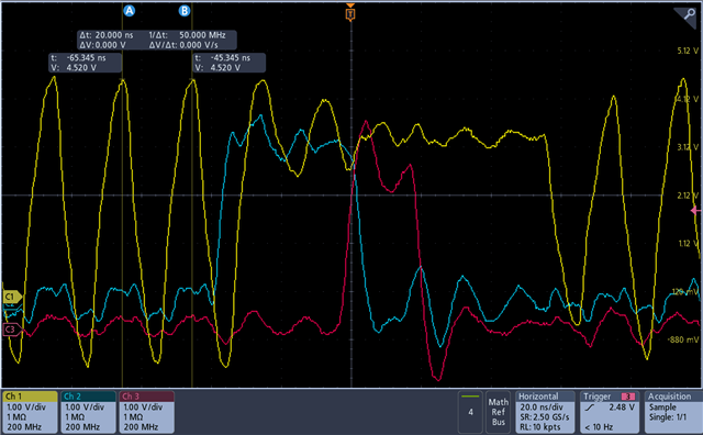

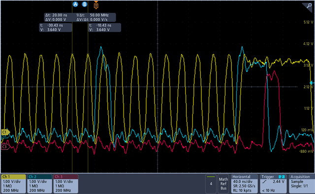

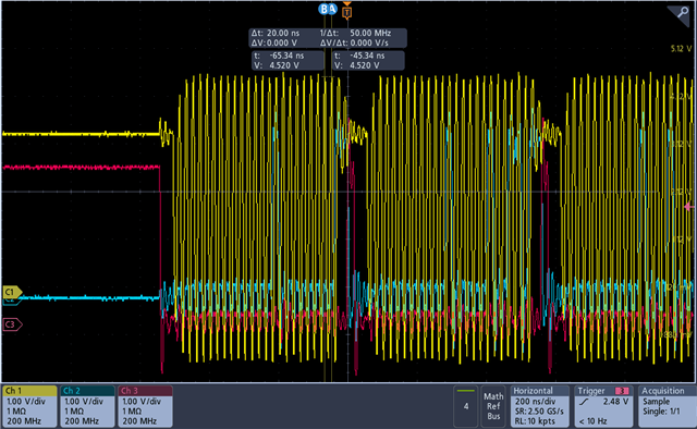

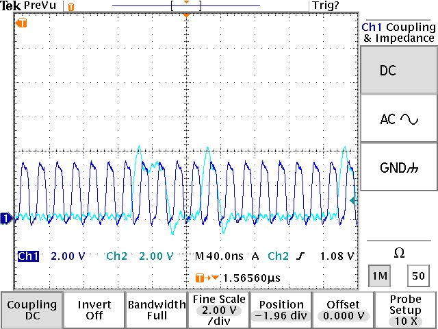

  • Yes, I can. Here the oscilloscope pictures.
    Here is the oscilloscope pictures for 22R before (MCU and 22R) .
    Yellow channel : CLK
    Blue channel : DATA
    Red channel : LE

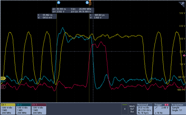

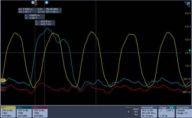

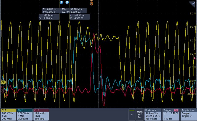

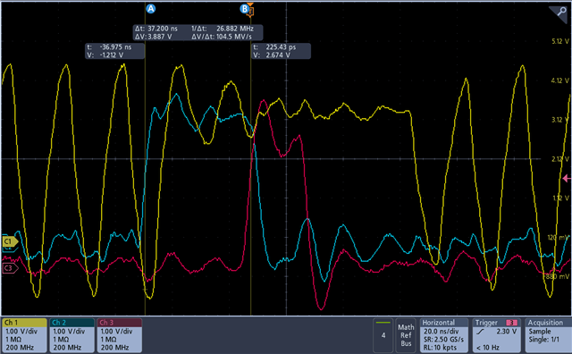

    Here is the oscilloscope pictures after 22R (PLL IC and 22R)
    I tried to measure using cursors. I am using passive probe along measuring.
    Also I didn't drive 25 MHz CLK: What is your advices?
    Thanks.
  • Hi There,
    At 20MHz, I expect I should see square wave signal.
    Please try again with higher SPI clock frequency.

    What is the SPI waveform before and after the 22Ω resistor?
    I shared measurings before for 50 MHz. I measured different speed. Waveforms don't change, they are almost like a sinus. I don't see any square wave for 20 MHz CLK or 25 MHz CLK. However I can program it. You are right for square wave if I try 100/200/500kHz or 1-2 MHz CLK speed. Also, I use passive probe and it applies low pass filter and square wave's edges can be less sharp. What exactly do you expect to see?
    Here is what I tried: choosing slew rate is fast, trying different spi masters and taking measurements from different oscilloscope.
    I think, waveforms are correct. Setup/hold, peak's voltage and slew rate is showned correct.
  • Hi There,

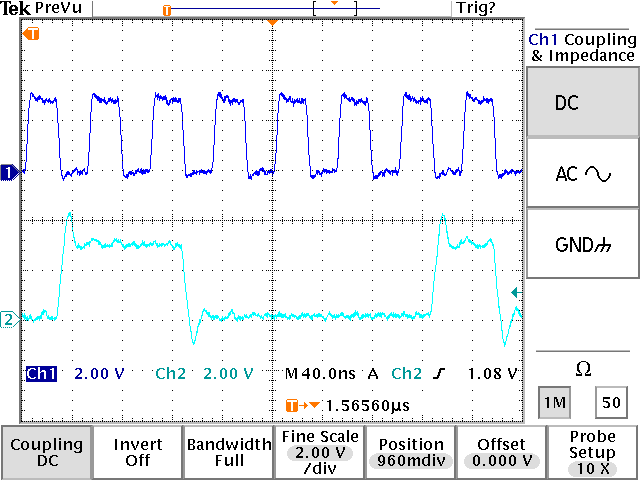

    With 20MHz SPI clock, I expect to see square wave signal.
    Below is the plot with 20MHz SPI clock after 22Ω resistor.
    With 50MHz SPI clock, I can program the device to lock.
    Your plot at 20MHz is much worst than my 50MHz plot, you need to verify the signal at 25MHz or above. If the signal has very bad distortion, LMX2492 may not be able to decode the information correctly.

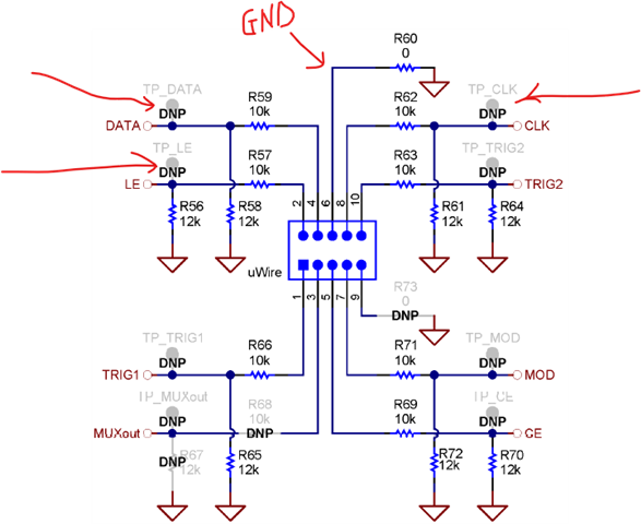

  • Hi again,
    I use LMX2492 demo board. It is very interesting because if I don't tie GND between Ic and controller, IC is programmed 50 MHz. If I tie GND between them just one point, it has never programmed. I tried to tie different single point, the result is same it isn't programming. However I tie multiple points, IC is programmed. What is your advices? Isn't it programmed strange without connection between GNDs?
  • Hi There,
    Both GND should be connected together. Did you connect your controller to the TP on the board?
    if you connect the controller to the pins of the uWire, you should change the 10kΩ series resistors to something like 33Ω.
