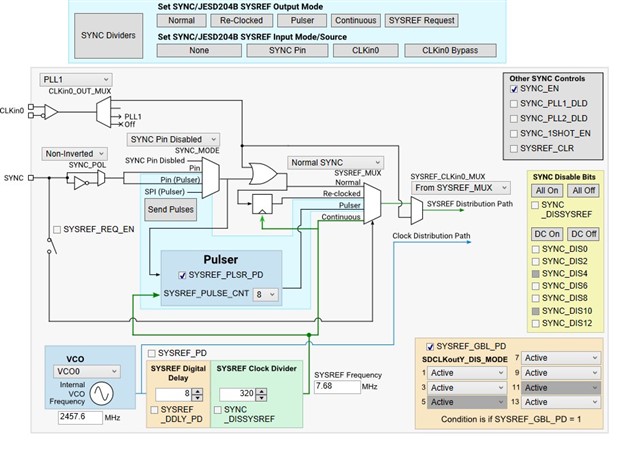

  • Hi Derek,
    Thanks for the quick response.  We are interfacing to a Xilinx (AMD) ZU49DR RFSoC.  One of the requirements is for the Sysref clock input (on the RFSoC)  to be 7.68MHz.  This is a Multi-Tile Sync (MTS) constraint.  So, it won't be possible to change that clock to 0.4MHz.  Also, we're using a ZCU216 Evaluation board for our development and don't have the option to use a different PLL.  However, I believe we could change our input reference clock to 122.88MHz and change the 160MHz VCXO to 122.88MHz as well.  If we make those changes and distribute 122.88MHz to all the boards as the reference input, will the outputs be phase aligned?  Or, would I also need to enable ZDM to make that happen?
    On SYNC/SYSREF settings, I would configure as shown in the attached image?

  • Hi Dan,
    Changing the input reference and the VCXO would ultimately not change the frequency of the clock distribution path (2.4576 GHz), but it would result in improved phase noise performance for the PLLs.
    Like Derek said above, the simplest course of action would be to use CLKin0 as a SYNC source and CLKin1 as the input for the reference.
    Michael

  • Hi Dan,
    Swapping the LMK04828 for the LMK04832 is the optimal course of action. The larger R Divider SYNC window is better suited for your multi-device system.
    Michael
