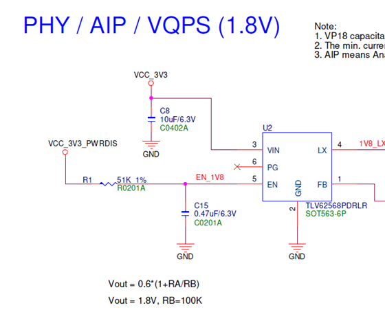

Part Number: TLV62568
Does TLV62568 EN pin have internal pull down?
I place a R1 51kohmm with 3.3V for seqeuce control is fine? thanks!

Hi Jeff,
The TLV62568 doesn't have a pull-down resistor, so 51k pull-up is ok.
