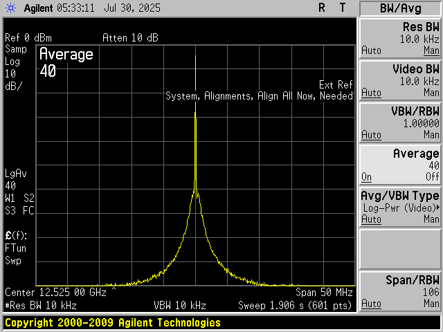

Q1:
Is it possible to output RFout B = RFout A / 3?
Example settings are as follows:
RFOUTA = 12.525 MHz
RFOUTB = 4.175 MHz
If this is possible, could you please tell me the settings?
Q2:
If dividing by 3 is not possible with Q1, it seems that harmonics of the set frequency are output from RFout B. Therefore, I am thinking of setting it to divide by 6 (extracting the RFout A / 6 component) and adding an external filter to extract twice the component of RFout B.
However, are there any concerns about device operation when using this method? For example, if I add a band-pass filter to RFout B and extract RFout B x 2, could the fundamental component of RFout B be reflected by the filter, causing the level to become unstable?

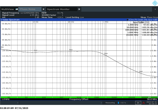

Q3:
The frequency I want to set is the setting for Q1. (There are three other settings.)
Since the reference signal Fosc is planned to be 25 MHz, I think I will have to set it to fractional, but I would like to know the recommended register settings to operate it under optimal conditions, such as minimum spurious, minimum phase noise, and maximum power output from RFout.
I would like to actually check this on an evaluation board, so it would be very helpful if you could tell me the settings in TICS Pro.

    Div by 3 is not supported, you can use div by 6 and then extract the second harmonic.
    I think we should first use a balun to turn the differential output to single-ended output and then go through a BPF to get the second harmonic signal.
    If the reference clock frequency is just 25MHz, we cannot get very good performance because the loop bandwidth is limited and the N-divider value is high.
    Can we use 100MHz reference clock? We can get good phase noise and spurs performance with a 100MHz input.
