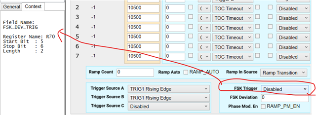

I have a question about FSK modulation settings.
Q1:
I believe the way to disable FSK modulation is to set FSK_DEV_TRIG, as listed in Table 20 of the datasheet. Is this correct?
The TICSPRO settings window is FSK trigger. (Disable is selectable.)
Q2:
If my understanding of Q1 is correct, I cannot find the FSK_DEV_TRIG bit in the datasheet.
Does this refer to FSK_TRIG[1:0]?
If so, I cannot find the Disable setting in the datasheet, but does Always Triggered mean the same thing as Disable?
If this is correct, I was confused about this, so could you please explain in more detail?
