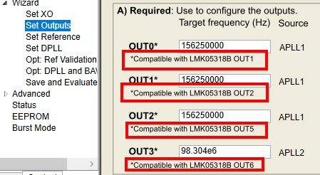

Hi teams,
My customer is using our LMK5B12204 and they have some related questions:
1.  Our LMK5B12204 does not have its own EVM right? We have to use the LMK05318B EVM for that?
2. Since the register map between LMK05318B & LMK5B12204, the configuration file generated by LMK05318B EVM is not able to be used for LMK5B12204 right?

  • Hi Liang ,
    1. Correct, no EVM for LMK5B12204. You would need to use LMK05318BEVM to test.
    2. The LMK05318B and LMK5B12204 are part of the same family. Therefore, they have the same register map but there is different naming convention used. The LMK5B12204 is the same as LMK05318B but with stripped down outputs.
      1. For example, OUT1 in LMK05318B is OUT0 in LMK5B12204, same registers.
      2. If you want to mimic the LMK5B12204 using LMK05318BEVM, I recommend programming the LMK05318B using the LMK5B12204 TICS Pro.
      3. From the LMK5B12204 TICS Pro you can see which outputs are compatible between LMK05318B and LMK5B12204:
