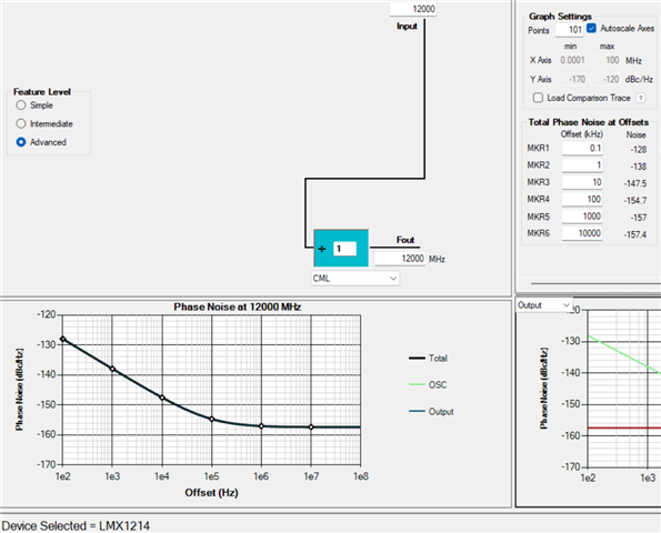

Hi Teams,
How much does the phase noise deteriorate between the input 12g signal and the output 12g signal of lmx1214? What is the phase noise situation when applying his auxiliary output to 3g at the same time? Can you check the phase noise at @ 10k, @ 100k, and @ 1M respectively?
