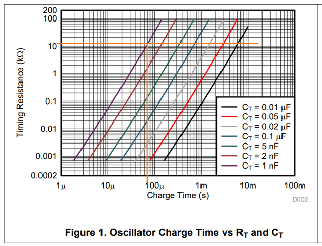

I wanted to set the oscillator frequency roughly 100kHz, So I used Rt = 13.3kohm and Ct = 1nF. But when I measured the output using an oscilloscope, I got the frequency output as 88kHz.
Please can you just what can be done.
That equation is not accurate so only provides numbers nearby. RD is also affecting the result.
In reality, you need to tune up RT to get the frequency you want to have.
