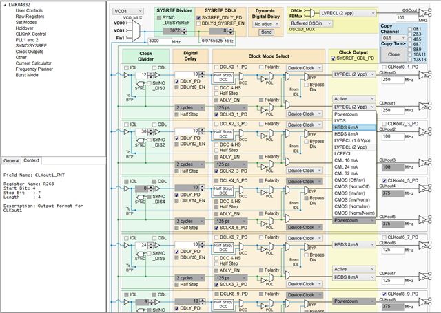

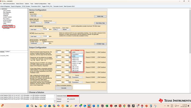

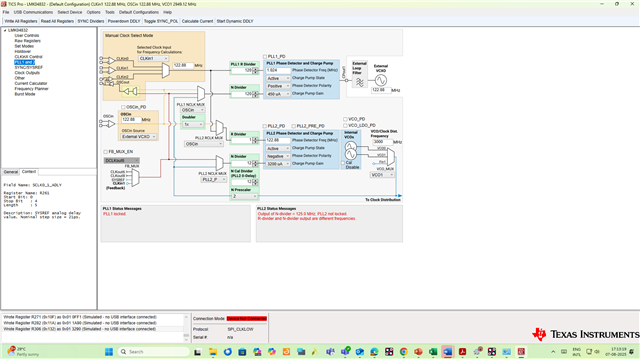

  • In Frequency Planner Section of LMK04832, I can't able to select the CMOS in the format. I need to generate CMOS for my output requirement. Can you check and confirm this?
  • Hi Dinesh,
    Change the output format in clock outputs flex page.
    Pl3aaee note not all outputs support LVCMOS output.
    best regards,
    vicente

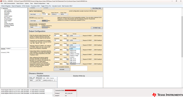

  • Hi Vicente,
    I have already changed the output format in Clock Output Page but in the Frequency Planner Page, CMOS Options are not there. I have checked the Evaluation Kit User Manual too. In that Frequency Planner Section is not there. Hereby, I attached the screenshot of that. Please check and let us know. Looking forward to the response.
    Dinesh
  • Hi Dinesh,
    Yes but you don't need the CMOS option to appaer in the planner.
    That planners main purpose is to ensure your frequency plan is possible to generate.
    Ensure you can output the frequencies you want for example in my case:
    I see a 3GHz VCO is one possible solution to this frequency plan and load the configuration.
    I see the correct frequencies.
    I can now go into each CLKoutx_FMT to change the output format.
    This is register controlled. Editing these fields directly changes the registers if we had a device connected. It effectively writes to the registers via SPI.
    Vicente

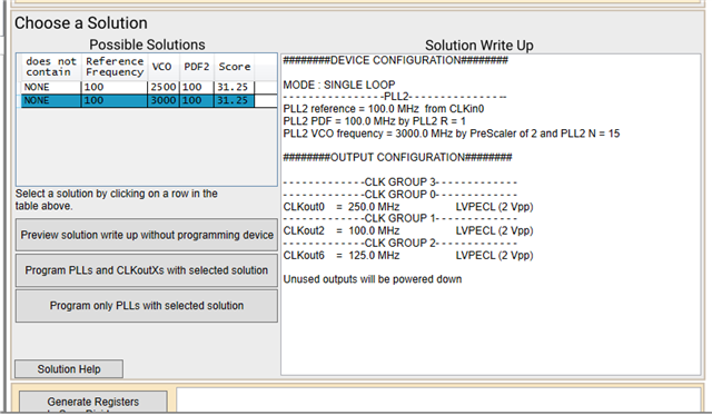

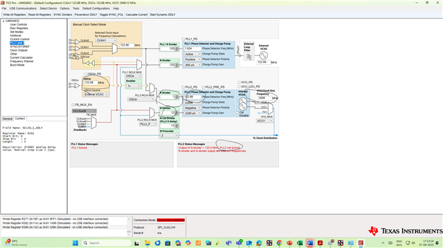

    If I provide 3000MHz in VCO1, the PLL2 is not locked. Is there any issue because of this? Please check and confirm. Attached the screenshot for reference. Looking forward to the response.
    Dinesh
  • Hi Dinesh,

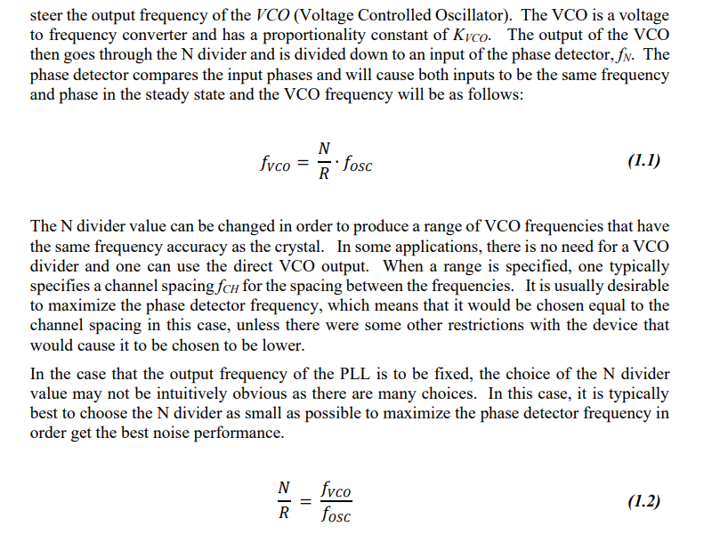

    PLL2 isn't locked as N/R value * PFD ! = VCO frequency (3GHz)
    There is a mathematical relationship between the VCO, and effecticely the PFD in this case.
    In your case, you have a 122.88MHz PFD frequency the total N divider (taking into account the prescaler) is 24.
    122.88MHz * 24 = 2949.12MHz
    Please upload a clock tree of what your input clock is and desired outputs.
    I see you uploaded this but in case somethings changed please include in your clock tree.
    As Derek mentioned, this frequency plan specifically cannot be generated by the LMK04832-SP as the VCO coverage is limited from 2440MHz to 3255MHz.
    Ensure the LCM of the outputs frequency you need falls under the VCO coverage range of the LMK04832-SP.
    Vicente

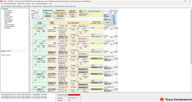

  • Hi Vicente,
    Please find the Frequency Requirements and based on this, please provide the solution to Lock the PLL2.
    Frequency Requirement:
    200MHz - LVDS
    100MHz - LVDS
    25MHz - LVCMOS
    24MHz - LVCMOS
    Dinesh

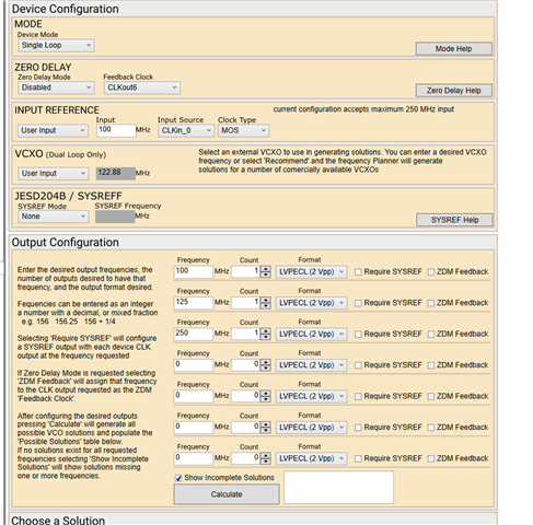

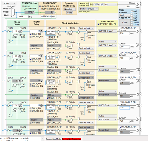

  • Hi Dinseh,
    What is your ref clk, is this a VCXO, XO, etc?
    Do you plan on jitter cleaning or is your ref clk clean and you only want to operate in single loop (PLL2 only) mode which effectively acts as a clock generator?
    I have created a config that assumes a 100MHz input with LMK04832 operating in single loop mode . 100MHzIn_SingleLoop_200_100_25_24MHzOut.tcs
    Vicente
  • Hi Vicente,
    REFCLK = 100MHz/125MHz from XO.
    Looking for the single loop mode.
    Attached Clock File looks Ok for our requirements. Thank you for that.
    Dinesh
  • Hi Dinesh,
    If utilizing a 100MHz XO - the config file is appropiate.
    I will be closing this thread now - reach out again if you have any further questions.
    Vicente
