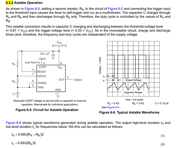

Hi all,
1
What is the accuracy of the H level time and L level time obtained from equations (1) and (2)?
I think it depends on variations in the constants of the resistors RA, RB and capacitor C used.
I would like to know if there is a correction value to obtain the maximum and minimum.
2
Is there a range of the constants of the resistors RA, RB and capacitor C used?
In equations (1) and (2), if the resistance value is multiplied by 1000 and the capacitance by 1/1000, the time will be equivalent.
Is there a problem that the constants are too large or too small?
