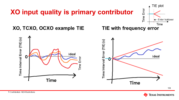

    LMK05318B can work with OCXO (through XO pins for APLL reference) in 30-100 MHz. When input reference become valid (PRIREF/SECREF pins), the device then can sync to these clocks through DPLL. In order to work in DPLL mode, the OCXO frequency needs to be in non-integer relation to BAW VCO1 2500 MHz. For example: 12.8 MHz, 19.2 MHz, 48 MHz, 38.88 MHz, etc.
    Reference input noise contribute to the outputs in a close-in jitter region. A typical jitter region is 12kHz-20MHz. XO (OCXO/TCXO) dominates noise <10kHz and REF noise dominates ~<100Hz depending on APLL and DPLL LBW which could also be optimized to narrow down to potentially filter input noise.

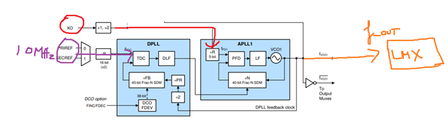

  • Thank you for the response. For me, it is compulsory to have 10 MHz as synchronization signal or reference to LMK on priority. The LMK out may be changed to the nearest non-integer value in the range 30- 100 MHz for LMX2595. Since I already explained to you my requirement, do you have any other part that I might have missed that would better fit the application?
  • So you need LMK05318B to provide input clock to LMX2595 instead of using OCXO CVHD950?
    LMK05318B could work here. LMK05318B can sync to 10 MHz through DPLL mode (using PRIREF/SECREF input), but in order to use DPLL mode, you'd need to choose XO input (XO/TCXO/OCXO) that has non-integer relation to BAW VCO1 2500 MHz as recommended above.
    In the absence of 10 MHz input, LMK05318B stays in holdover and the long term stability of holdover depends on the XO being used (OCXO > TCXO > XO). When 10 MHz is back valid, the device continue to sync to 10 MHz.

    Another question is that the external 10 MHz could be absent for a long duration, and phase noise is critical in application so in holdover for long time will phase noise be maintained without the external 10 MHz, and if not, can you suggest any XO/OCXO part to have as second priority on board 10 MHz to automatically switch to ?.
    In the absence of 10 MHz input, the device enters holdover which allows the output clocks continue running without major disruption. For example, if XO has -1ppm and REF 10 MHz is 0 ppm. At start-up, output clock is at -1ppm because it references the XO. When the device locked to 10 MHz, the output is at 0 ppm. When REF 10 MHz is lost, the device enters holdover and the output maintains the ppm error of 0 ppm based on the history being accumulated during DPLL lock. Over long time holdover, it might drift away from 0ppm depending on TIE plot of the XO/TCXO/OCXO being used. When REF 10 MHz is back valid, device exists holdover and starts locking to REF 10 MHz at the ppm error of the input.
    You could also use XO/OCXO/TCXO to SECREF (assume the first 10 MHz is PRIREF). When PRIREF is lost and SECREF is valid, the device perform hitless switching allowing the output continue to run without changing in phase (phase cancellation) or gradually migrate to the new phase (phase slew control).

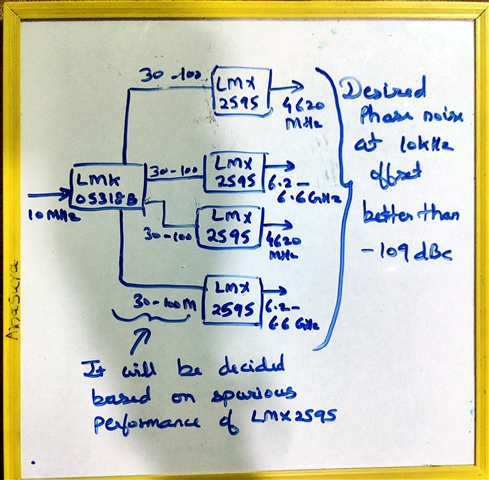

  • Thank you for the timely response.
    The reference frequency would be decided based on spurious performance.
    For better visualization please refer the attached image of part of the system. Spurious below -75dBc desired after up down conversion, the mixer or up/dn module is not shown in below image.
    The input reference to lmx2595 although is written 30-100MHz, but we have to perform iterations for lowest spur and it will start from 20MHz. Mostly it should be between 20-40 MHz as I observed through formula given in lmx2595 datasheet. You may suggest if you have any better ideas for same.

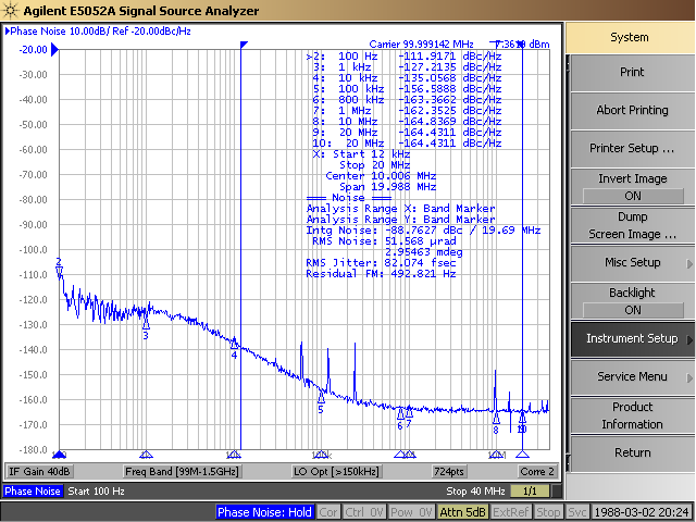

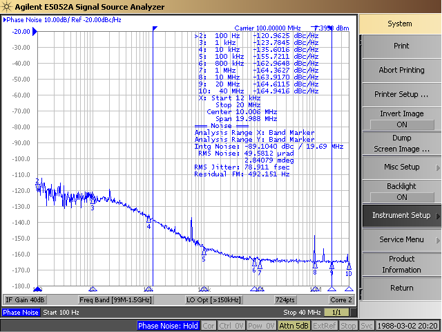

  • Hi Akshay,

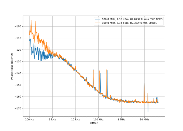

    Here is 50 MHz and 100 MHz taken with TXC TCXO 48 MHz and 48.0048 MHz (APLL mode). The 48MHz TCXO would provide less spurious on output phase noise.
    I don't have an OCXO 10 MHz to test with DPLL. But here is the 100 MHz phase noise with TXC TCXO 48.0048 MHz and 10 MHz from a signal generator to PRIREF to show you the close-in area where PRIREF contributes - this area is optimized through DPLL LBW. This data is at 100 Hz DPLL LBW. With a smaller DPLL LBW, input noise will be filtered out more.
    TXC TCXO used: 48 MHz - 7N48071001, 48.0048 MHz - 8W48070002

  • Hi Riley
    Thank you for the response and detailed analysis.
    My understanding is that the phase noise results are for 100 MHz out with 48 MHz and 48.004 MHz TCXOs, from which the 48 MHz results appear better at a 100 Hz offset. Using a 10 MHz signal from a signal generator for the DPLL, the 100 MHz phase noise results look promising, and 100 Hz offset results can be improved using LBW tweeking.

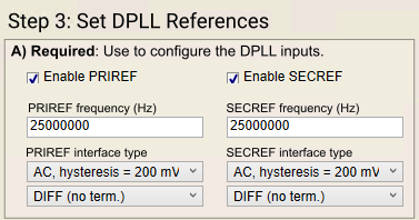

    We have received the EVAL board, as discussed with DPLL disabled and internal XO used, the phase noise of LMX2595 is degrading, so I must use an external TCXO. The TCXO suggested by you is not available anywhere for purchase. Candefault settings_LMK05318B.tcs you please share a part number or series that could be available for purchase?
    Attached are the default settings of TICS pro used for testing with DPLL disabled, since we were not connecting PRIREF at this moment, but it would be required. 16 dBc degradation at 10 KHz offset for 6370 MHz out from LMX2595 with reference 100 MHz given from LMK05318Bevm.

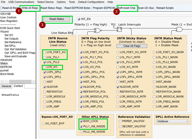

    I would recommend to test with a general input source (signal generator) for XO input at 48 MHz to ensure LMK05318B is proper configured and output is meeting the need before purchasing TCXO for further test.

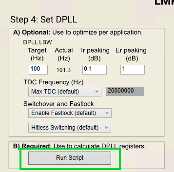

    You'd need to set XO = 48 MHz, set output to 100 MHz and do Calculate frequency plan.
    Set Reference to 10 MHz and Run Script. It is ok to not have PRIREF/SECREF input at this moment, the device will not validate the input so DPLL is not attempting to lock.
    Do Write all regs and Soft-reset chip then check device status. The highlighted bits should be as shown for APLL mode lock and output is at correct frequency.
