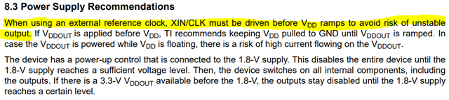

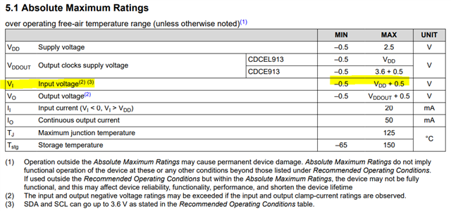

Hi All,
I have a question about the CDCEL913's 8.3 Power Supply Recommendations.
The 8.3 Power Supply Recommendations are listed below.
However, the Absolute Maximum Ratings for the input voltage are after VDD is input.
Which should take priority?
