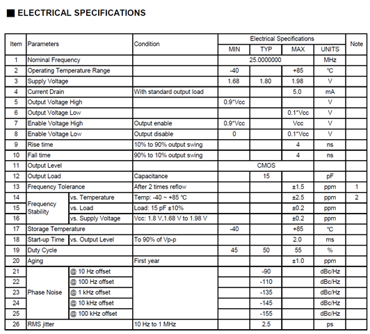

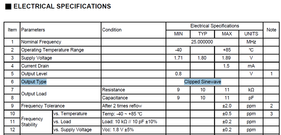

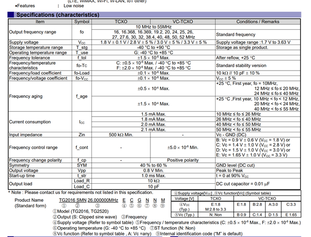

Is there a suggested circuit for connecting a 1.8V clipped sine wave to the input of the TCXO? I have the following clock connected:

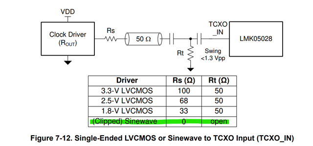

I have also connected the output using the following circuit as suggested by the datasheet with 100nF capacitors

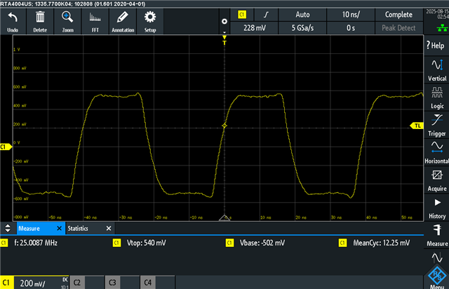

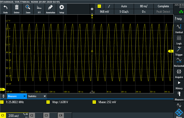

Below are some screenshots of the waveform at the output of the oscillator and TCXO_IN
Below is The Clock output (before the 2 100nF capacitors)
Below is the measurement at TCXO_IN

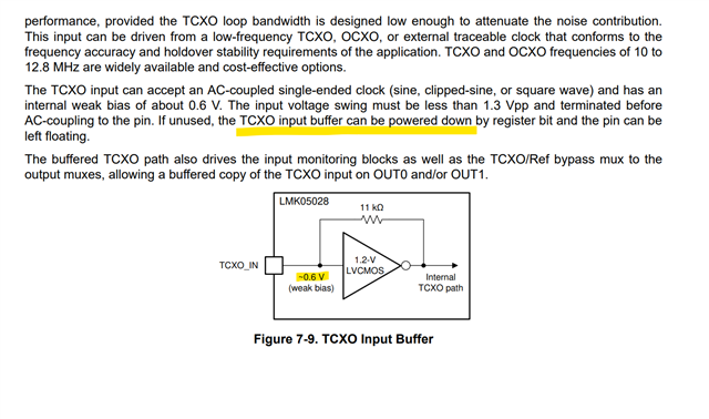

The TCXO does not detect for 25Mhz. I am curious if that is because the wave form is not <1.3Vpp
