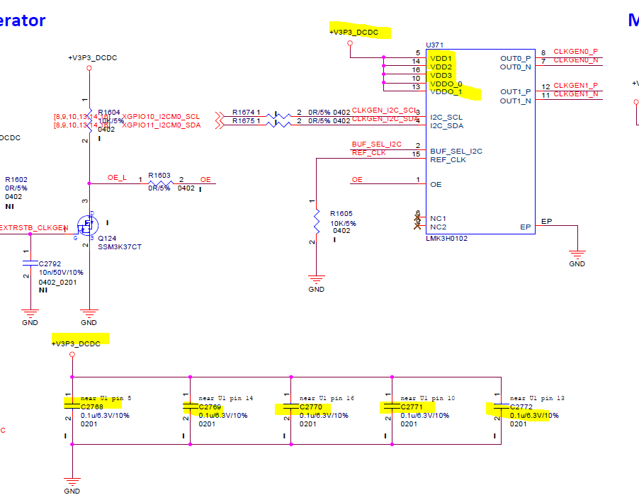

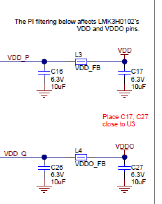

I have a question regarding the LMK3H0102A015RERR EVB. I noticed that there is a PI filter circuit reserved on both VDD and VDDO power rails, as shown below.
However, I couldn’t find any specific mention of this in the datasheet.
  1. Is it necessary to implement a PI filter on these rails? If yes, do you have any recommendations for the bead specifications?
  2. Regarding the decoupling capacitors shown in the schematic below, is it acceptable to use 1 μF and 0.1 μF for VDD/VDDO?
Thanks!
