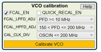

  • Hi Turker,
    Here is the procedure to complete an InstCal calibration without using the VCO doubler.

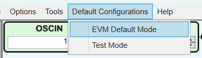

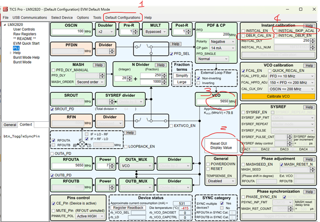

    TICS Pro setup:
    1. Select EVM Default Mode
    2. click this button to refresh the GUI
    3. Change VCO frequency to 5650MHz
    4. uncheck these bits
    5. Enable double buffer bits
    Programming:
    6. Vcc power up the EVM
    7. Provide a 100MHz signal to OSCin
    8. Program all the registers (Ctrl+L or USB Communications --> Write All Registers)
    9. The EVM should lock to 5650MHz and the LD LED should lit

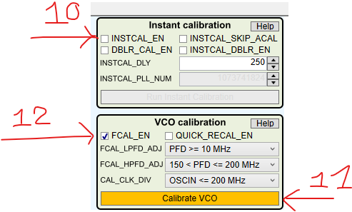

    InstCal calibration:
    10. Check INSTCAL_EN
    11. Click Calibrate VCO button once (LD LED will turn OFF)
    12. Uncheck FCAL_EN (LD LED will lit, calibration is complete)

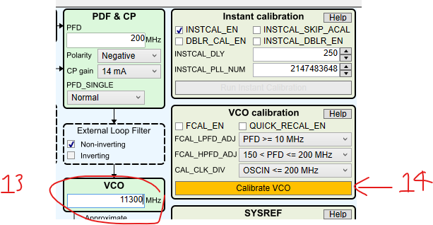

    To change frequency:
    13. Change VCO frequency
    14. Click Calibrate VCO button once (it should lock to the new frequency)
