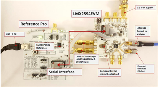

I am attempting to generate a 160 MHz differential output and a 10.24 GHz single-ended output using a Reference Pro board as the reference source and the LMX2594 evaluation board.
I configured the LMX2594 to accept a differential clock input and connected the boards together exactly as shown in the example connection diagram in the datasheet. The Reference Pro board circuit has not been modified. It is configured to output a 100 MHz clock with OS = 0, OE = 1, and LVPECL format.

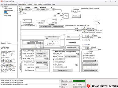

In TICS Pro, I selected the LMX2594, applied the configuration shown in the attached screenshot, and clicked “Write All” to program the registers. However, I am not observing any output from the LMX2594.

    Make sure the Reference PRO board is configured properly and you can measure 100MHz from the output.

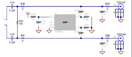

    If you connect Ref PRO differentially to the LMX2594 EVM, modify the input of the EVM as shown below:
    Your TICS Pro configuration is fine.

    I have already modified the EVM input as suggested and checked the circuit, and I can confirm that the Reference Pro board is outputting a 100 MHz differential signal correctly.

  • It seems that the LMX2594 is neither locking nor giving any output. The screenshot I attached is what I get when I click Read Focused Register in TICS Pro. How can I properly check whether the device is locked or not?

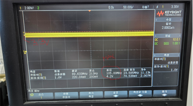

  • When I probe the C14/C15 node on the LMX2594EVM with an oscilloscope, I observe a 100 MHz waveform riding on an unexpectedly high DC level of about 3 V.
    This does not look normal to me. Is this expected behavior, or does it indicate an issue?

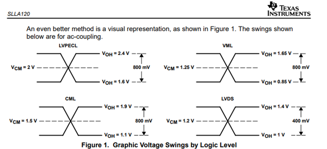

  • As a follow-up, I have attached an oscilloscope screenshot of the C14/C15 measurement, along with a reference diagram of typical differential signaling voltage swings.
    Given that the observed DC bias is around 3 V, which seems higher than the common-mode levels shown in the reference standards, could you please clarify whether this behavior is expected for the LMX2594EVM input?
