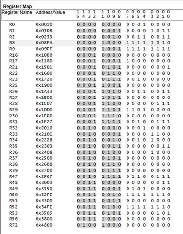

We put the LMK61E08-SIAR on a PCB and we we able to turn it on and program it. The output frequency would not update. I have replaced the IC with a new IC. It was initially visible on I2C but after attempting to program it, it has disappeared. An suggestions on what might be happening? I can swap out the IC for a new one but it would be good to have some idea of what is going on and why we cannot get a programmed IC to output the frequency that we would like.

    Can you scan the bus to see if the device responds to a different I2C address? It's possible that when you reprogrammed the EEPROM R8 was updated and changed the device's I2C address. Also, can you send over the register configuration that you programmed to the device?

    Thanks for the reply. Yes after you mentioned it, we did notice that the I2C address changed. We are still unable to get an output frequency.
    Here is the register configuration:
    R0 0x0010
    R1 0x010B
    R2 0x0233
    R8 0x08FA
    R9 0x09FF

    This is the register readout:

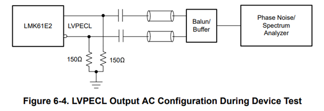

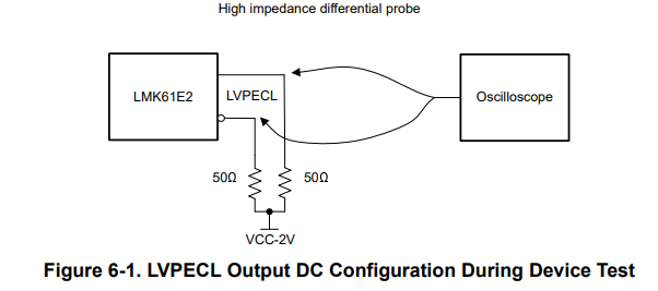

  • Hi Ryan,
    Looking at R21, it looks like the device is configured for LVPECL. Do you have the proper LVPECL termination on your board? If you don't have emitter resistors in the DC path you may not be able to see an output. Here are some examples of valid LVPECL termination schemes:
    Connor

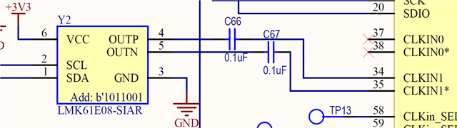

  • HI Connor,
    We made some adjustments and set the output to be LVDS. There is still no output.

    This is the output circuit.
    Thanks!
    Danny
  • Hi Ryan,
    The register configuration and schematic look correct for LVDS (assuming CLKIN of the receiver has an internal 100 Ohm differential termination). When you mention that you don't see an output, are you probing the signal close to the CLKIN pins? Or are you checking the status/output of the receiver?
    One other thing to try, could you set SWR2PLL = 1 (R72[1]) after loading the config to manually reset the PLL?
    Connor
  • Hi Connor,
    I am probing at C66 and C67 with an oscilloscope.
    We tried the SW2PLL =1 but still do not see a waveform.
    Danny
