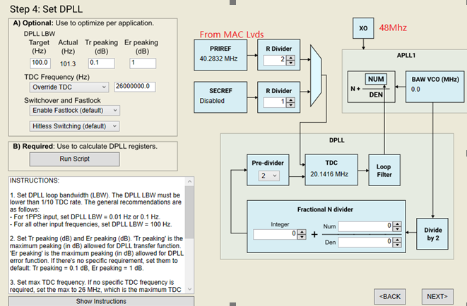

Hi team,
our customer is using LMK05318 and met below issue, can you help to see what may lead to below behavior?
While debugging the LMK05318B, I discovered a significant deviation from the 156.25 MHz output frequency, causing the connected port to go LINK DOWN. The following table shows the test results.
156.25 MHz Clock Test
Normal Frequency Measured by Oscilloscope
Actual Test Frequency
Frequency Deviation
Converted to PPM
Normal
156.24023M
Negative Deviation
156.13812M
10211
653.5ppm
Positive Deviation
156.47512M
234890
1503.3ppm
Positive Deviation
156.27420M
33970
217.4ppm
The LMK05318B operates normally in freerun mode for extended periods. However, in SYNCE mode, the device operates normally for the first few hours, but then experiences increasing frequency deviation (from a minimum of 2 hours to a maximum of 15 hours), causing the prototype device and the peer port to experience a link down.
