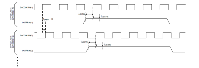

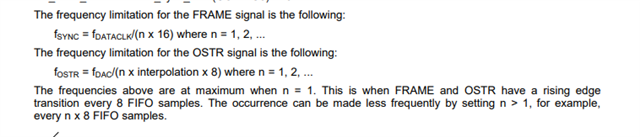

I am planning to use 4 DAC3283 DACs for my Analog signal generation. I need to phase match all the 8 outputs of DAC (2 from 4 each), and planning to provide DAC Clock and OSTR (4 each) from single clock generator (Jitter cleaner) LMK04832. Is this setup okay? Since OSTR is not a clock type output I am worried how this will behave. Can you suggest how I can interface these.
DAC Clock and OSTR relation
DAC clock clock synthesizer interface
